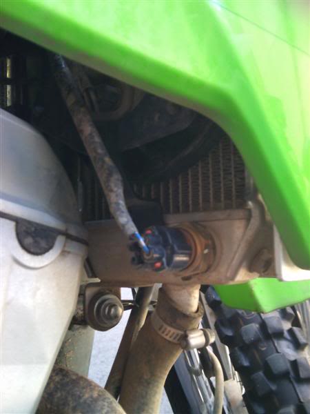

Given those temps I should be worried, but what isn't clear to me is where the fan temp sensor is placed for turning the fan on/off. Looking at my bike it seems the switch is at the bottom of the radiator before the water heads down to the pump - therefore it's on the cold side. So maybe the temps aren't a problem then as you would expect them to be highest as they come out of the cylinder... right?

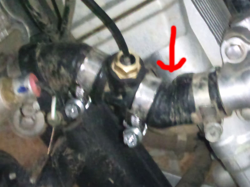

So based on your feedback it was clear my cooling system had a problem, and I am sure it was my poor skills when connecting up the temp sensor. I took it off, and put it in a cup of freshly boiled water to see if the sensor was potentially faulty. It read just over 90C (194F) and I am pretty much sea lever so the boiling point of water is 100C (212F). So if anything the sensor is under-reading rather than over-reading. So the problem was clearly not the sensor.
This is how my first attempt at the sensor install looked like:
As you can see where the red arrow is, I had kinked the hose a bit. I think this was because I had not cut enough hose out before installing the sensor. I cut another 4mm off the radiator side of the hose, re-installed the sensor and tried to minimise hose king when re-tightening the hose clamps. As you can see below, it's still not perfect, but seems a lot better. On my test ride with ambients around 23C (73F) my temps seemed to stabilise around the 75C (167F) mark. Didn't go above 81C (178F). So I think I have sorted the problem out now.
