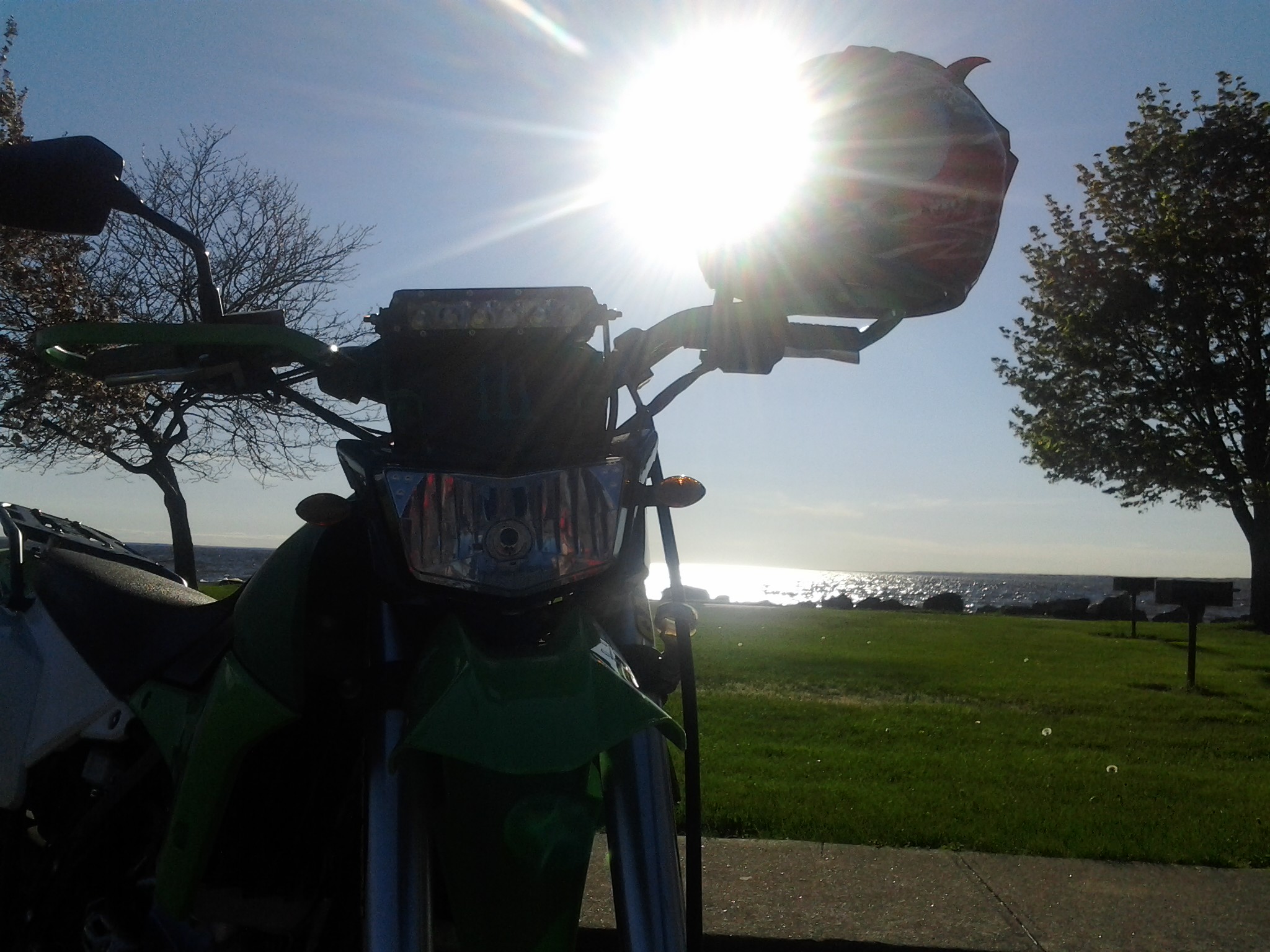

Here ya go, its an 09.

Thanks for the pic, looks great. Is the gap between the fender and headlight OK?

It's perfect, don't have a pic but it fits just like the stock one, like it was made for it
