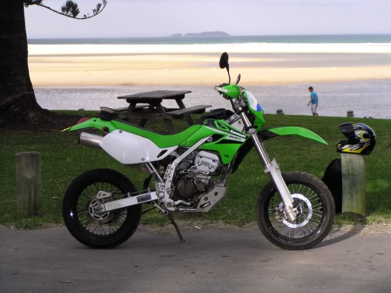

What sort of riding does he do? Road, dirt, mixture? You could try 17" rims off a D-Tracker.
