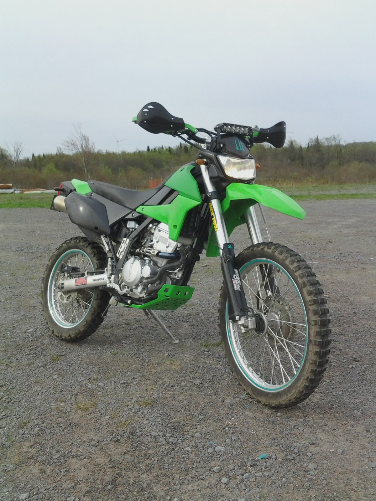

Old May 26, 2016 | 02:23 PM
Tacoma660's Avatar
Joined: Jan 2014
Posts: 805
From: Rome, NY
edge drc tail light with 12 0clock lab board, it integrates the turn signals in the brake light so no turn signals stick out. Full wrap around hand guards to protect your hand and levers.

Old May 26, 2016 | 03:23 PM
edenwilliams@hotmail.com's Avatar
Joined: May 2016
Posts: 4
I like that LED bar !!

Old May 26, 2016 | 07:41 PM
Tacoma660's Avatar
Joined: Jan 2014
Posts: 805
From: Rome, NY
the led bar is around 2100 lumens but they have a 3x3 cube that puts out 3100 lumens. lifetimeleds.com. That is the kind of riding i like to do, the slow technical kind bores me.
