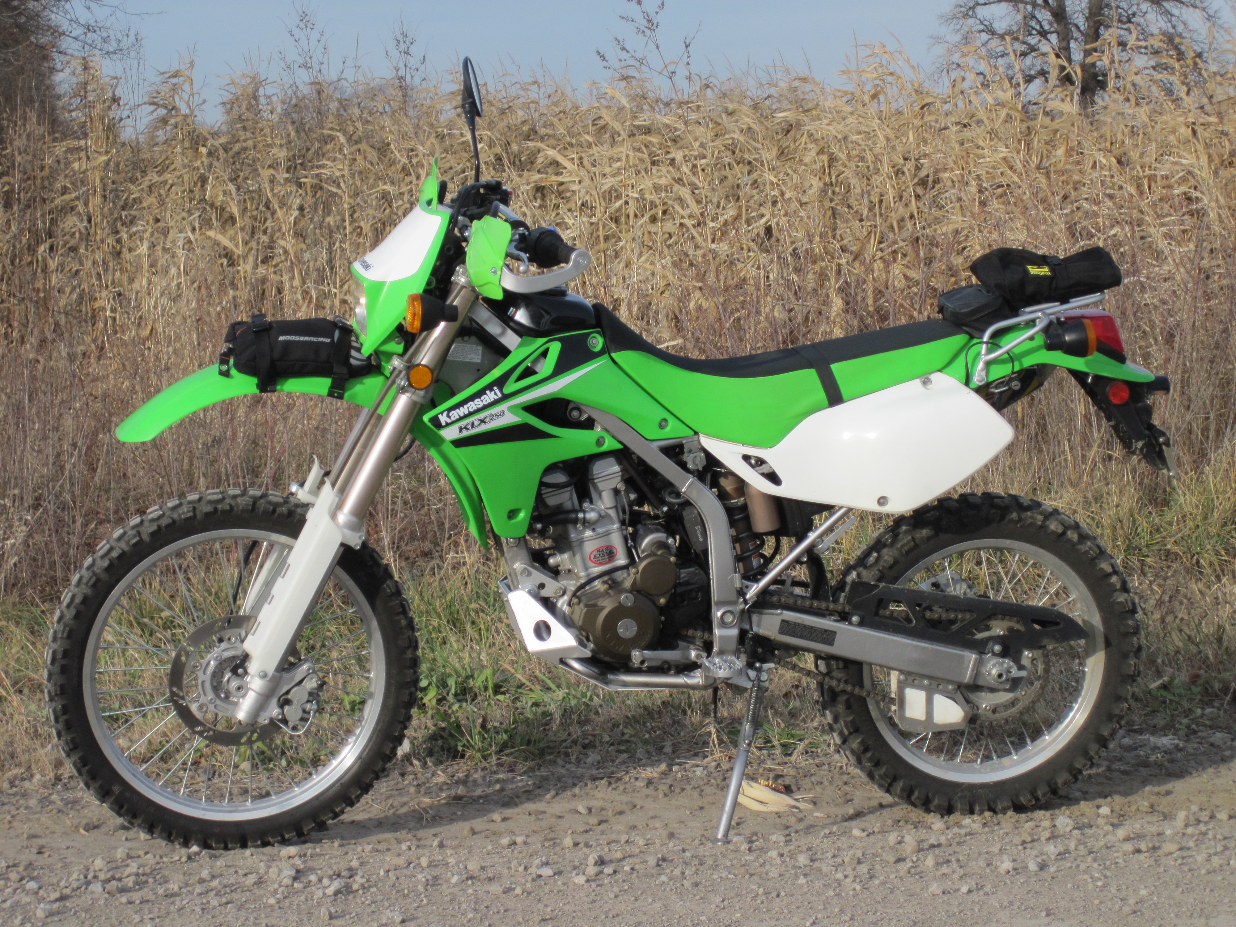

It's funny you say that. It's entirely possible to have a klx 250 with electric start and kick start. I did the 351 kit when I put the kick starter in it. So now I have a electric and kick start klx351 ! It's the best of all options.
351 hiding in there with the stock 250 decals still on the fairing
