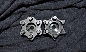

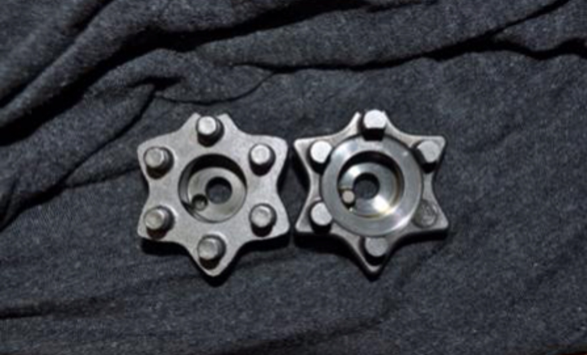

Factory Kawasaki took steps to put safeties in the way of breaking your trans... soft bendable shift lever, they machined in a step to weaken the shift Star. To make sure the owner wouldn’t suffer transmission issues. I put in the earlier/stronger shift star so I’m going to run the flexy/repairable shifter... probably should carry a second on those do or die rides haha
