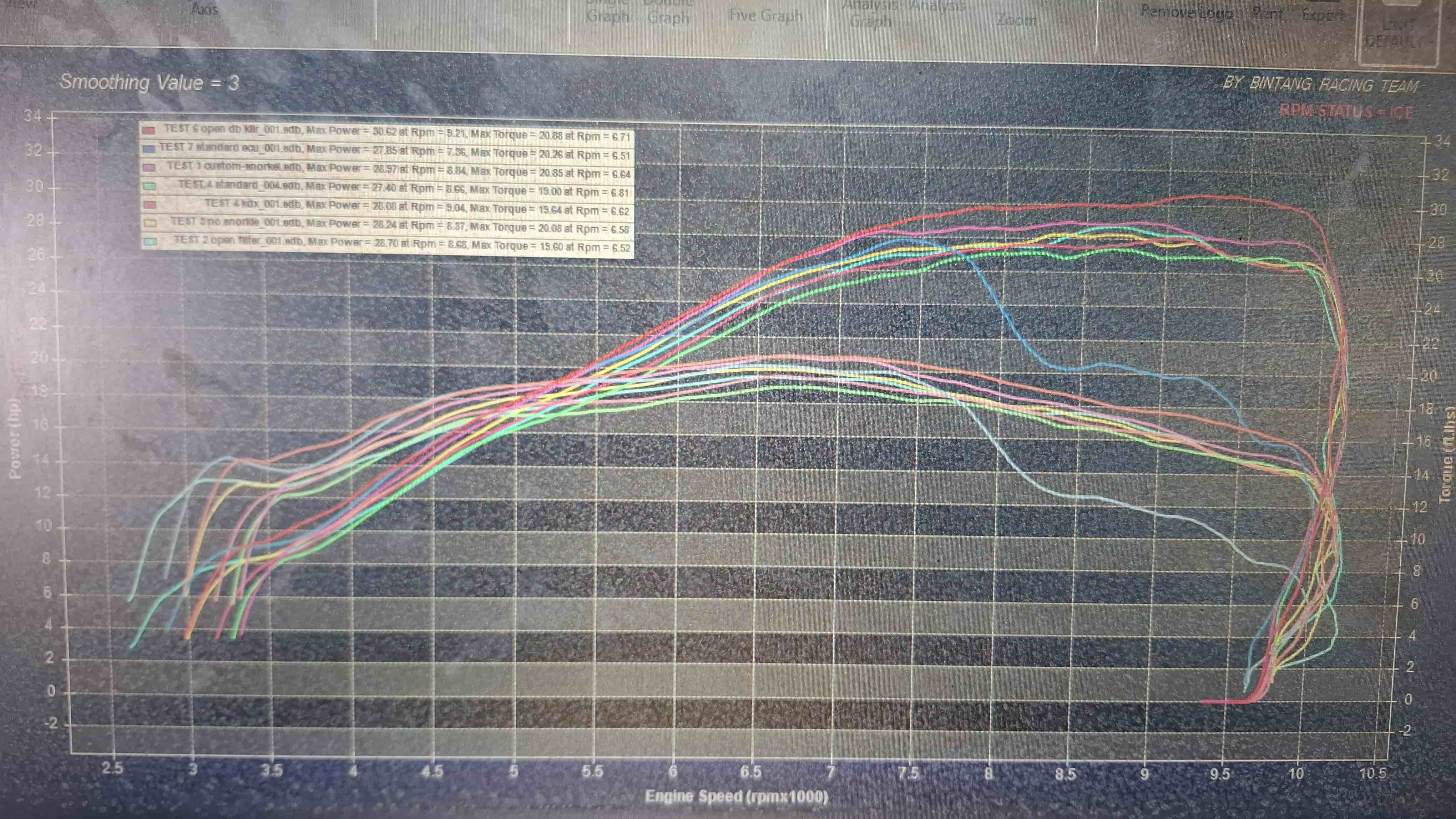

Hi folks. Finally put together a video with the intakes dyno testing and updated intake section at planetklx2 -
For those who want to learn something I highly recommend to watch the video and let's discuss results!
Short takeaways:

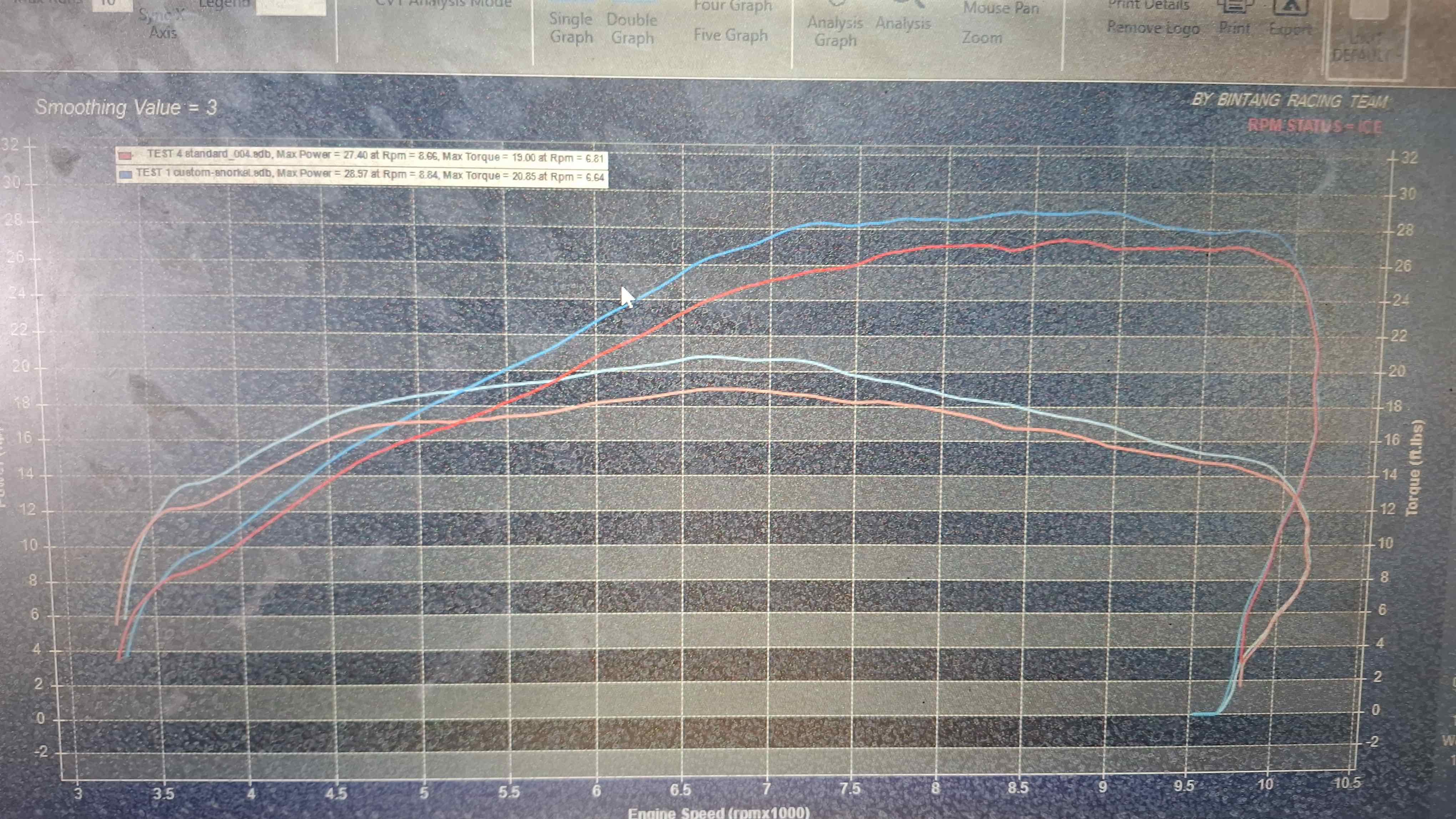

Custom-vs-standard
Custom vs standard

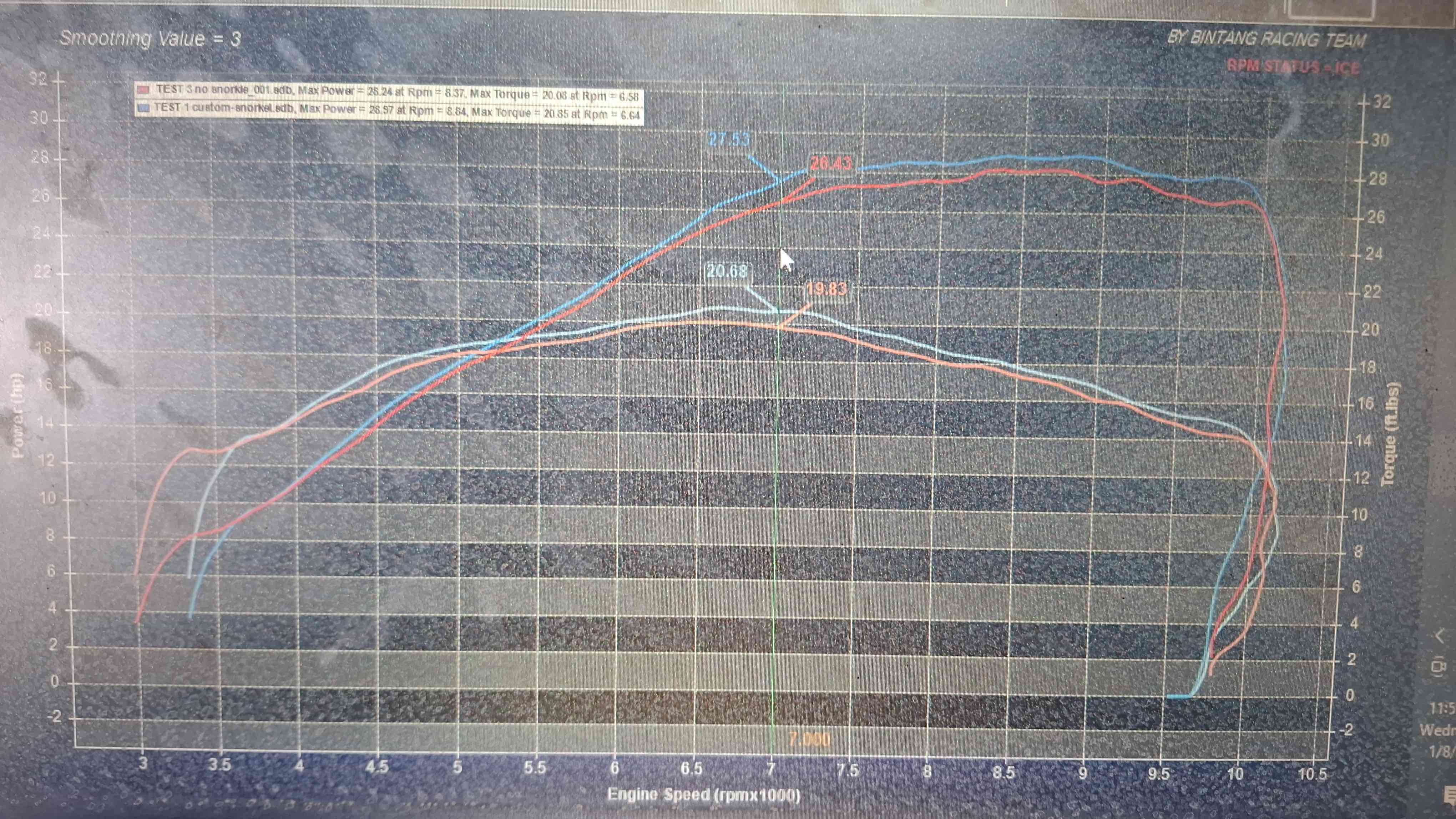

Custom-vs-snorkelless

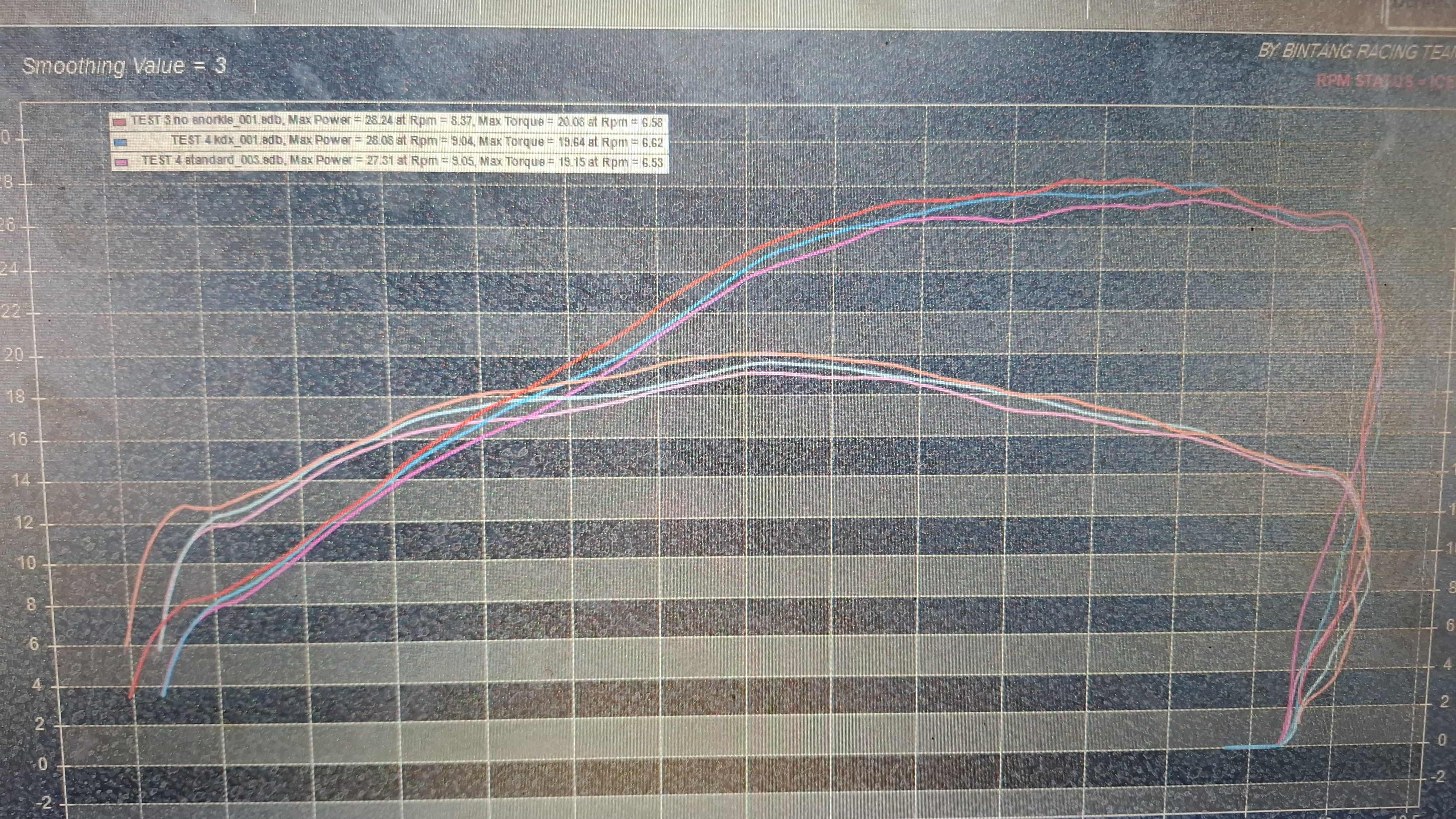

Snorkelless-vs-standard-vs-KDX

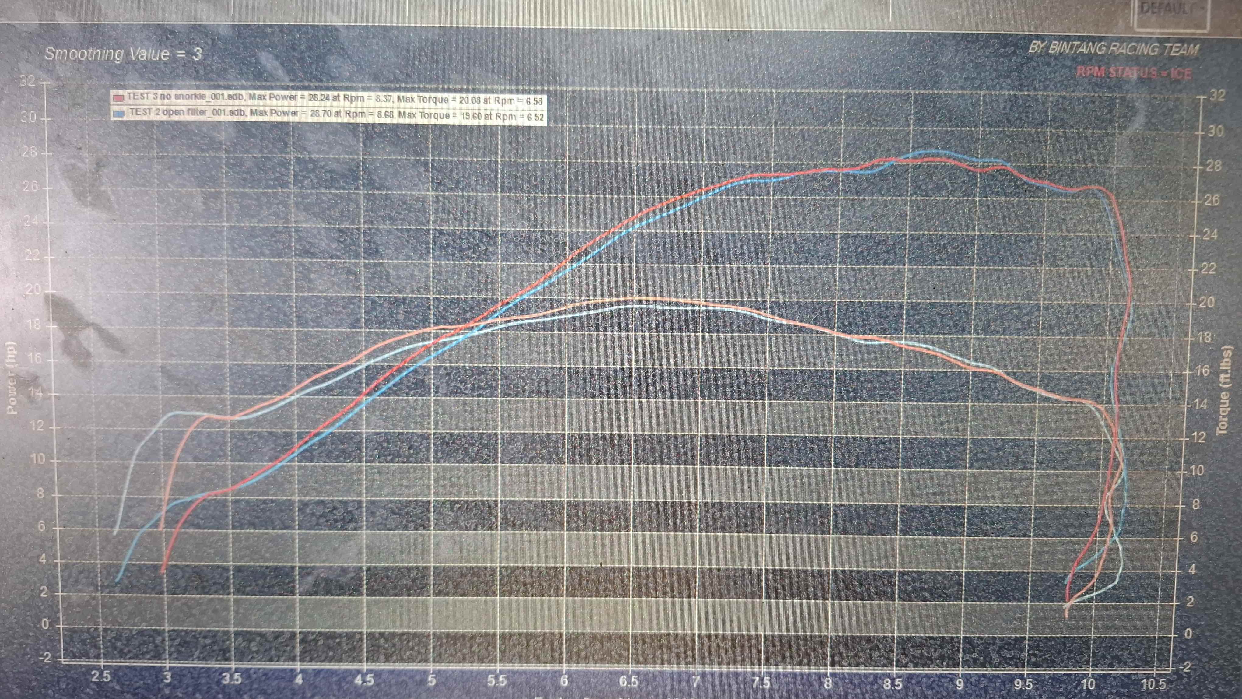

Lidless-vs-snorkelless

- First of all I'm very surprised that my custom snorkel performed even better than lidless! It's over 2.5 hp over standard, 2 hp over KDX and 1 hp over snorkelless. I think it's better that lidless due to likely lower flow velocity. Given that my custom snorkel just slightly more loud that KDX it's a big win and far beyond my expectations from that project.
- Secondly I found lidless is more or less is the same as snorkelless (lid in place, snorkel out).

The "odd" results of the lidless airbox, in your testing, is likely explained by the AFR ( fueling ) charting ( which you do not show ).
A open airbox requires different fueling - Without re-tuning the fueling for the increased airflow of a open airbox, the AFR ( fueling ) probably went so lean as to cost power.
The relative restrictiveness of your lid ( compared to a lidless airbox ) likely caused the fueling to remain within tolerance for power production.
Nonetheless, BRAVO for the work you've done and new option you've given to all.

I was targeting about 12.5:1 with my snorkel. So lidless might be about 13:1. Still within an AFR range which provide max power.
