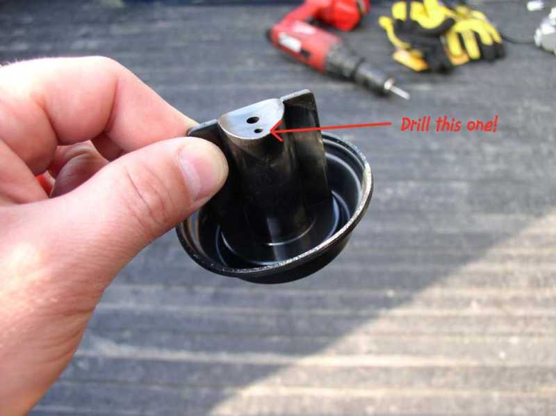

Hey lukeorion, you dont HAVE to drill the slide with any kit. The kit that I got said to drill it and even came with the drill bit but I didnt drill it and I still have a huge difference in performance. The major gains are going to come from the jetting difference although I would like to know how much more difference you can get from drilling the slide.
Old Apr 29, 2010 | 11:46 PM
WestOzKLX's Avatar
Posts: 3,229
If you don't want to drill the slide (WHY!) then just cut 2 turns out of the stock spring and you'll have a similar effect, or you can wire two turns together with lockwire to shorten the spring.
Here'a pic' for those that wonder!
And another.
