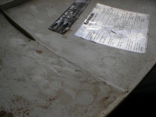

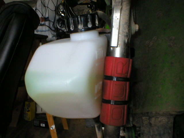

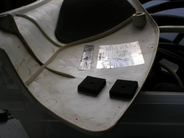

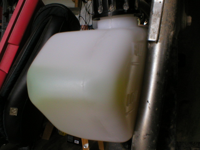

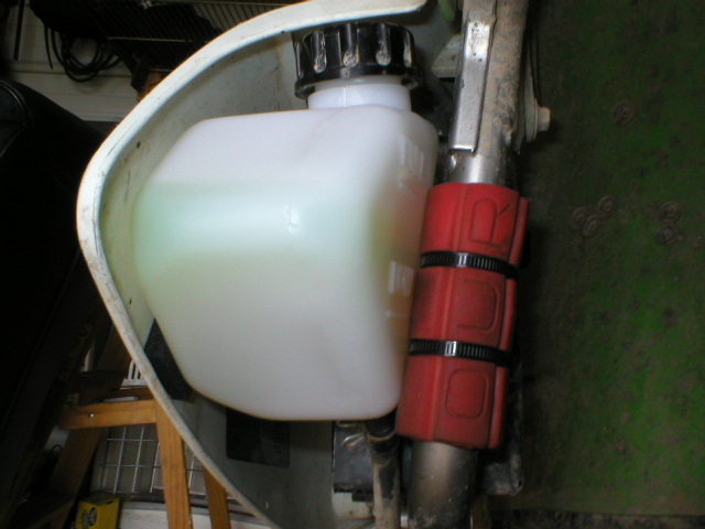

I got home and ordered up a new tank at the shop I used to work at...surprisingly not that expensive even at retail. When installing the new tank, I saw a couple of thing I didn't like and that may have contributed to the tank cracking in the first place.
In pic one you can see the tank is pressed into the battery/coolant tank frame tube when it's tightened down. The old one had some serious rub marks from this spot. I used an old Oury bicycle grip to wrap the frame tube and tied it down with a pair of zip ties. Also the number plate/side panel has a stiffening ridge that had been rubbing the tank enough to start flattening that ridge. Not a big deal normally, but after a few impacts, that's a concentrated point of impact during some crashes...or tipovers. I removed some of that ridge so it's flat at that spot now. I also added 2 stick-on foam pads to the side panel for more impact absorbing capability. When bolting the overflow tank to the frame, I also used a pair of rubber backed metal washers between the tank and frame. This spaced the tank out just a hair to ease stress on the mounting tabs and isolates the tank a bit more from the frame.
Overkill?...most assuredly so...but it cost nothing with just some junk and spare parts around the shop. Never throw anything away...LOL! The tank is better isolated now from both vibration and from impacts causing it to be hammered against the frame tube. Not a big deal, but something you might do when working back there at some point, or if you have to replace an overflow tank in the future.
