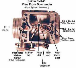

Cold starts are problematic for quite a few KLX's. The starter jet is on the small side, so the choke doesn't allow enough fuel to start a cold motor in many cases. This is a fixed brass jet pressed into the carb body and is not replaceable. Drilling out this jet to .018" solves the hard cold starting. It has no effect on anything else when the choke **** is closed, so it doesn't screw anything up.
