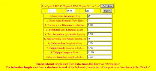

I used this calculator to do a bit of educated guessing on exhaust head pipe length and size. I used the specs I had available from earlier 250 timing at 61 BBDC with change for the retarding and figured 8600 rpm based on Kawasaki's peak. Comes up with an ID a bit over 1-5/16".
