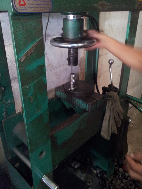

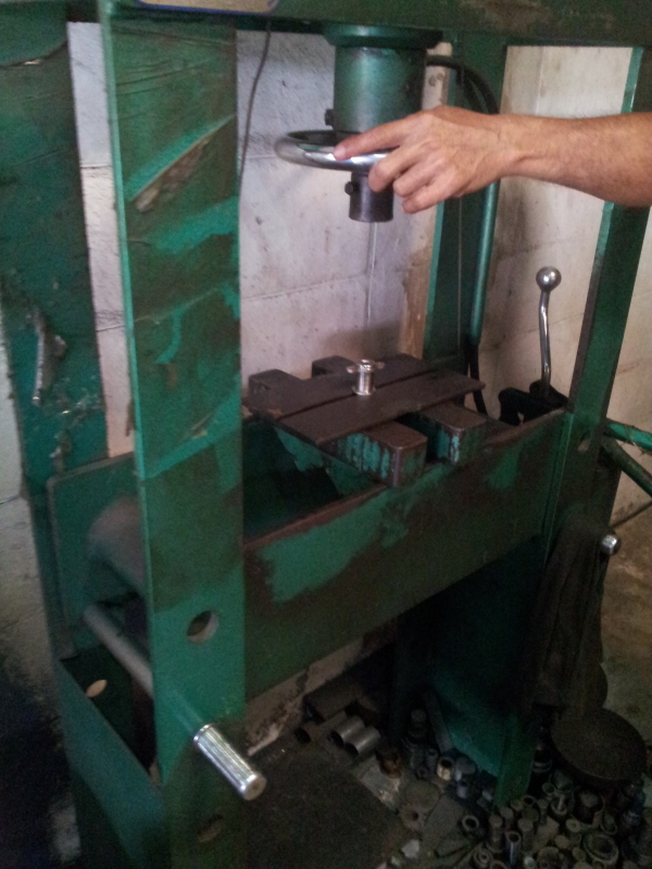

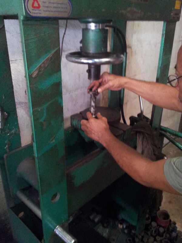

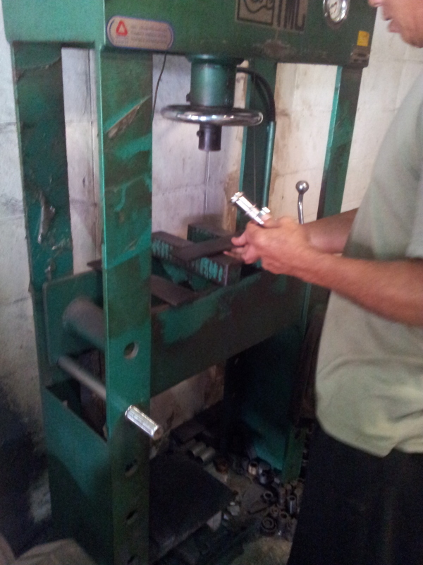

Originally Posted by Jules083
Just read the whole thread twice, wanted to make sure of a couple points before I go through with it. Note that I currently have a stock 2012, and will be adding a DG slip-on and removing the airbox lid at the same time. + jetting of course.
1. Doing only the intake side is a viable alternative, and gives some power increase but not full potential, correct?
2. I understand the ACR mod, but have not seen a good how-to pictorial. I'm not positive if I would try it myself or take it to a shop. Either way I'd like to be able to show the shop exactly what needs done rather than them blindly figure it out. I've lost faith in repair shops over the years.
Am I correct in thinking that the cam itself is hollow, and the ACR is acting like a 'cap' on the end? So basically secure the cam then push the ACR out from the inside, then turn and press the whole assembly back together? That seems easy enough. It also sounds like any good machine shop should be able to do the work, or even be a 'home brew' solution with a few different options.
Kansas-klx talks about a homebrew method using a bolt, chunk of metal, and grease. Seems like it would work, as it did for him. How is it going back on? I'm picturing just throwing the entire assembly in a press and the ACR just sliding back into place. Not sure how much pressure is needed, as I have a homemade press type jig that uses a bottle jack. It's crude but has gotten the job done before.
3. As much as I don't want to admit it a big bore kit might be in my future. Not sure when though. Would it be logical for me to do the intake side only, then if and when I do the BB kit just put everything back? Would save on ACR work X2 at least, as the cam mod doesn't seem to help once you go big bore. Perhaps the ACR work is easier than I'm picturing though. Mainly I haven't seen any talk of just how tight it is on there.
Thanks for any help.
the acr will come off with a shop press. Any halfway decent machine shop will have something to supportit...i think we just used a plate with a curve cut out of it
Seems to be the key phrase in your statement.
Once I get it out I think I have 2 good options now. Machine shop is the backup plan, I have a few good ideas on where to go. If Klxster's method works for me that'll be even better.
Thank you for the pictures.
