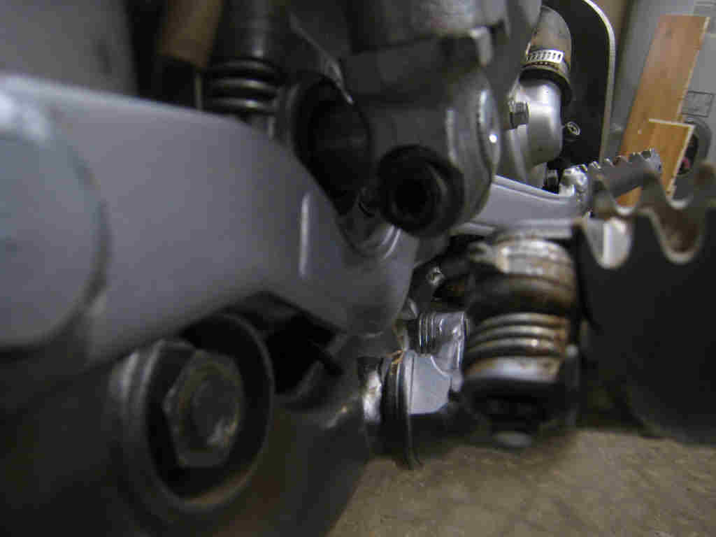

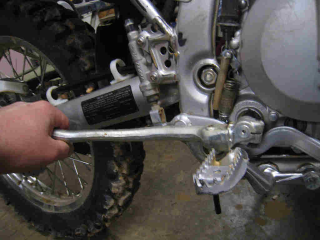

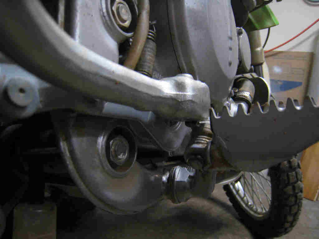

The foot peg mount wouldn't clear until I put about 1/4" stack of washers between the frame and the mount. Now it just won't let the kick start go through the full range of motion. I am going to try the 07 mount or something similar, a coworker put onto a motorcycle wrecking yard about 30 minuets away.
Old Feb 3, 2010 | 12:51 AM
  #76
Greendragon's Avatar
Joined: Aug 2009
Posts: 16
From: East Texas
A couple shots of where I'm at now.
Attached Thumbnails  Kickstarter Install w/pics-img_0843.jpg    Kickstarter Install w/pics-img_0844.jpg    Kickstarter Install w/pics-img_0845.jpg

Man, it sucks that you got that far just to be held up by something like that. Good pics, though, now I see what you're saying. Good luck on the '07 foot peg mount, I hope that works.
