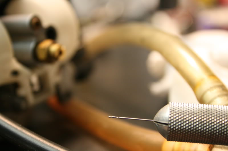

A defective KACR isn't a very common failure item. The starting issue where some have mentioned a dealership modding the KACR to allow more compression is one possible method of dealing with the poor cold starting, but I think the drilling of the starter jet is a bit easier and maybe better for the starter and battery. The starter jet allows the compression to be maintained at the lower level as designed with the KACR while providing the extra fuel needed for cold starting.
I think you have posted a picture before of the starter jet. Could you or someone post it again so i know what one it is. This will be done this summer when I do the 351 kit. Wow, another thing to add to my list. Drill bit #77? Just want to make sure I've got everything I need for when I have the bike apart so I won't have to do it again, or have the bike down for longer than needed.

Here's a pic. I'm not sure on the #77 standard, as I used an .018" version. The "77" is probably just a different standard but same size.
#77 = 0.018" = 0.4572mm
Ride on
Brewster

Thanks for the pictures and the equation.
