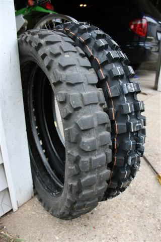

Here is a pic of my original stock Dunlop tire 4.60 next to a new Dunlop D 606 in the 120mm width.
Dan
