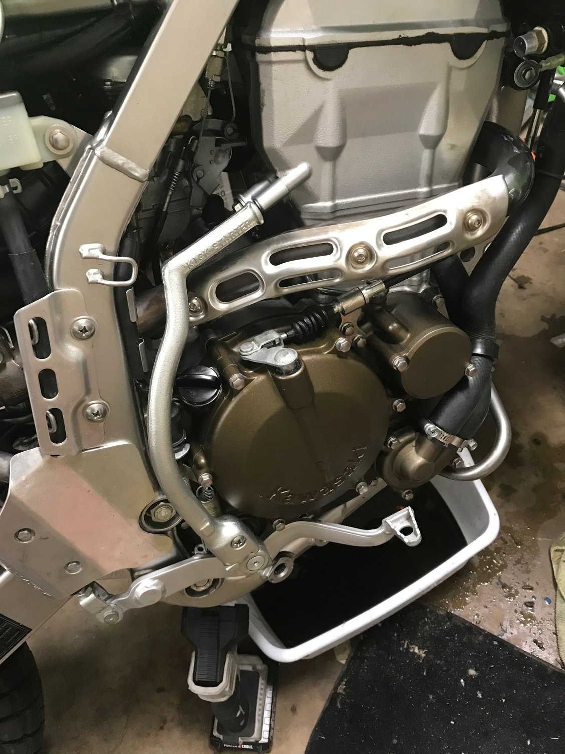

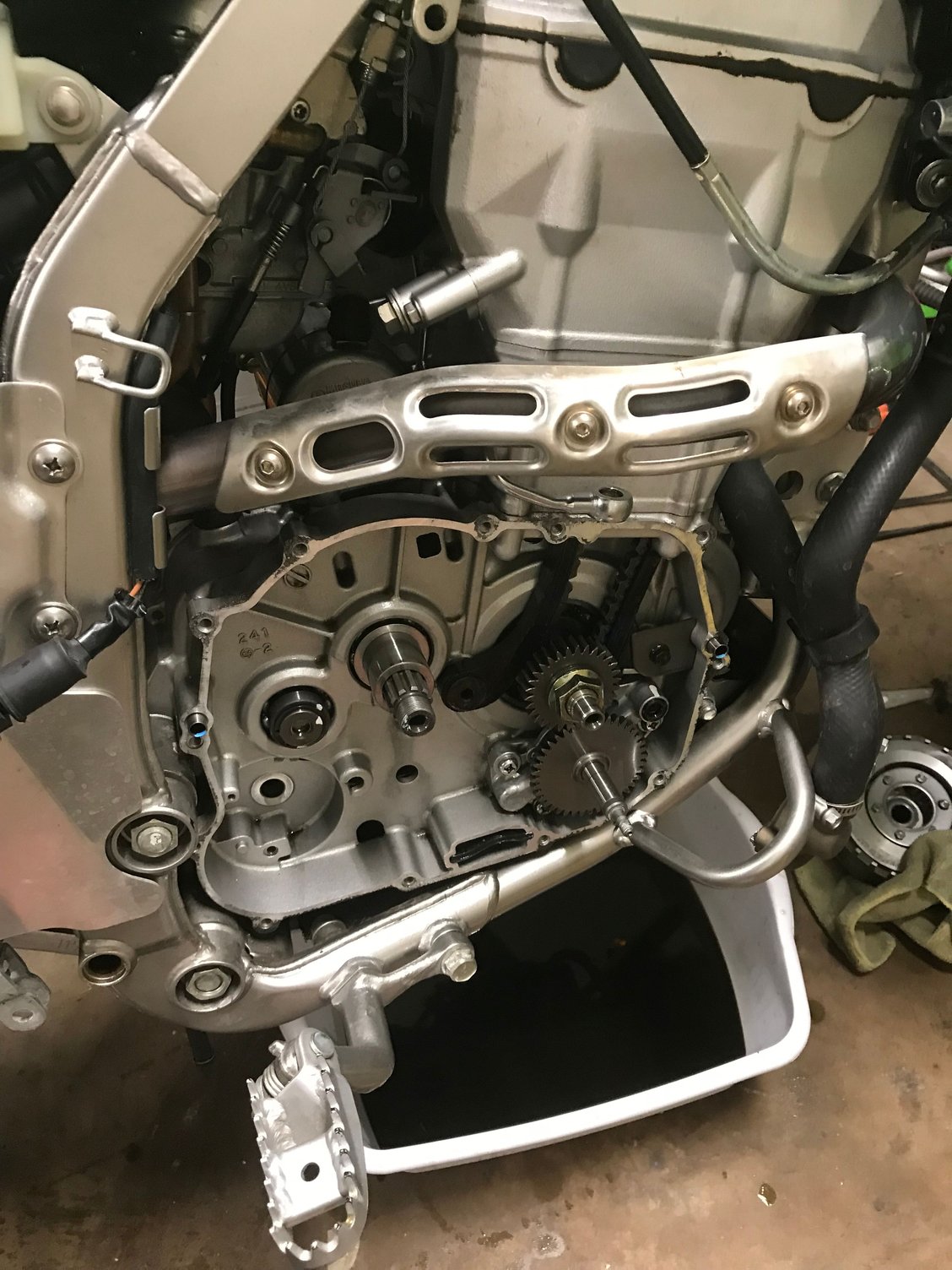

Hello,
My 07 KLX250 had a weak battery and I bought a OEM kick start kit on close out long ago so today was the day.
thanks to the internet articles and the service manual it was fun but long.
The tear down.
98% complete ..Tested and working.
This is my 2nd 07 KLX250. I call it new old stock because it has less than 355 miles on it. Still has the breakin sticker on the tach.
‘Cheers.
