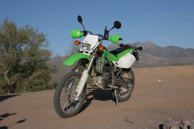

P.S. Here's a pic from my last ride a few weeks ago out east of Phoenix.
