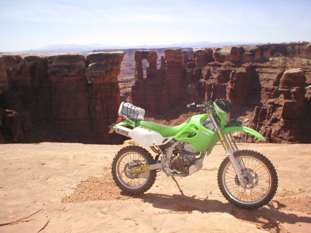

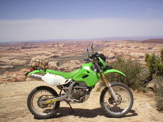

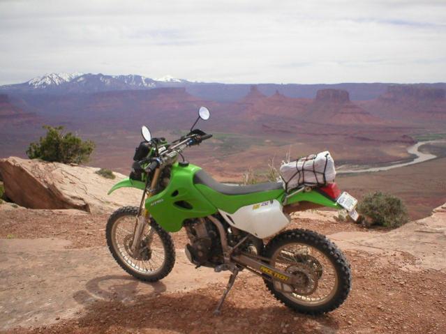

A quick recap on the bike...full Muzzy exhaust...Kaw 300 cylinder/piston...Dynojetting of 128 main, DJ needle, 35 pilot, modded airbox, Kouba fuel screw...Acerbis 3.7 tank...Vapor instruments...no turn signals (not needed for Texas registration)...Nuetech tubeless...full Racetech front and rear suspension mods...14/47 gearing.

The Race Tech suspension mods were so worth doing on this bike. All the rocks, ledges, and ruts were just eaten alive by the suspension. The wheels stayed on the ground getting constant and reliable traction when needed, and losing traction on scrabbly, gnarly climbs is critical on Moab's terrain.
The Nuetech tubeless setup with a Pirelli MT21 in front and a Kenda Trakmaster in the rear was totally bombproof. Tubeless Slime was in both tires and the cactus and rocks never challenged either tire. I ran 18 psi in the tires, mainly out of some fear of rim damage, but frankly I'm pretty sure I could go decently lower. The rocks and ledges at Moab kept me on the higher side of pressure just to insure a no-problems trip. Traction was still excellent, and this bike would tractor up just about anything. I'm constantly amazed at the tractable powerband of this bike. I've run the Nuetech system for about 8 months now with no issue at all. The inner liner tube stayed at a constant pressure and being able to tweak the main tire pressure just like a normal tube setup was nice...even though I pretty much settled on 18 psi for the norm.
I installed DID's best 520 X-ring chain, and while I can't believe this, I haven't needed to adjust the chain since I installed it about 8 months ago. I keep checking, and it keeps staying at the original recommended slack. I don't get it. I've put about 2000 mainly off road miles on this bike, and the chain hasn't needed adjustment. I don't use this bike on pavement very much at all. I use Dupont's dry wax PFTE chain lube from Lowe's for about $5 a can, so nothing special there. Frankly this amazes me and makes no sense. Yeah, this bike isn't a KTM690 powerhouse of chain stretching force, but come on.
Another surprise was that I didn't even have to touch the Kouba fuel screw when we skirted altitudes of nearly 10,000 feet on a couple of rides in the La Sals area. I also didn't notice any great power sucking demise in power at altitude. I was a little worried about this for my summer Colorado trip that I always take, but now I feel a little better about how this bike will handle those higher altitudes in CO. I think CV carbs are a benefit in this particular area.
