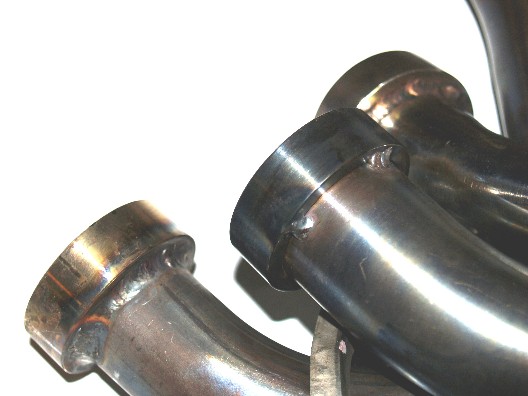

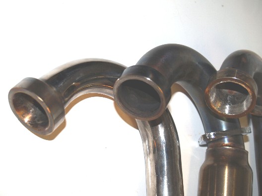

"It has abrupt internal welds and its inlet face does not mate well with the exhaust port."
The header flange I.D. needs to match the exhaust port on the cylinder head.
https://www.kawasakiforums.com/forum...erbomb-006-jpg
https://www.kawasakiforums.com/forum...erbomb-013-jpg
Two pics of a modified stock header and FMF header, using the copper gasket as the I.D. guide.
