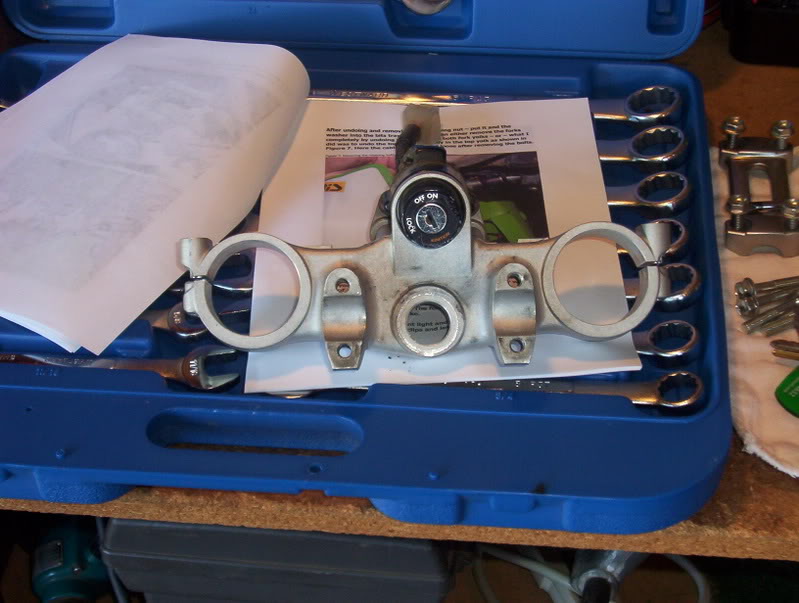

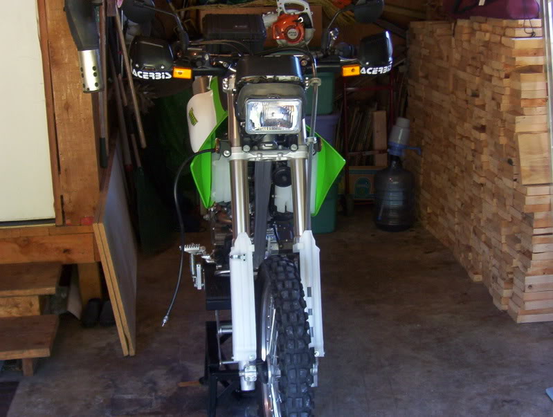

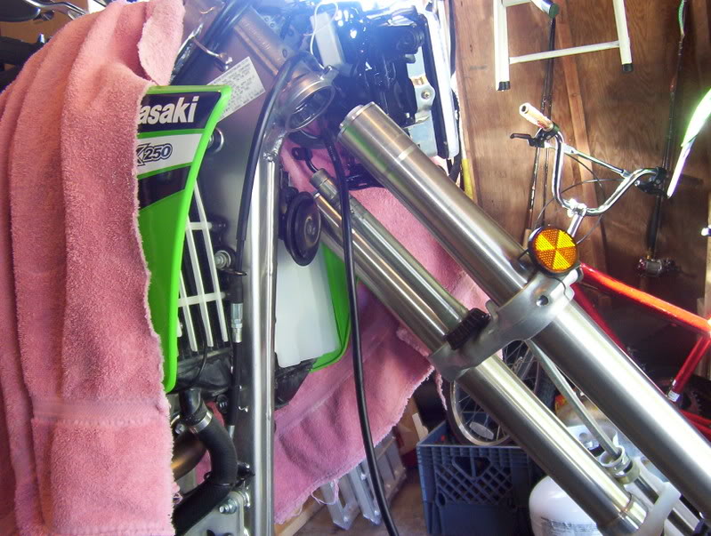

Ok so I just couldn't stand it anymore and besides that it was beginning to become a safety issue. The steering was really starting to annoy me when it would get stuck and have to be forced over on slow corners, so I decided to tackle the project today. So enjoy the pics.
All ready to be taken apart.
And of course good tools and organization is a must for any job. And yes that's a container of comet, back off.

Hey look, old school chopper look.......ok maybe not.

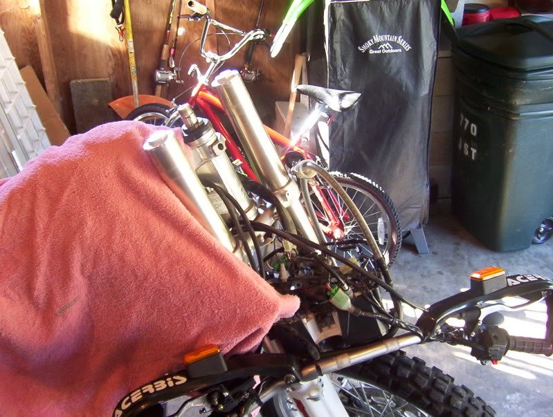

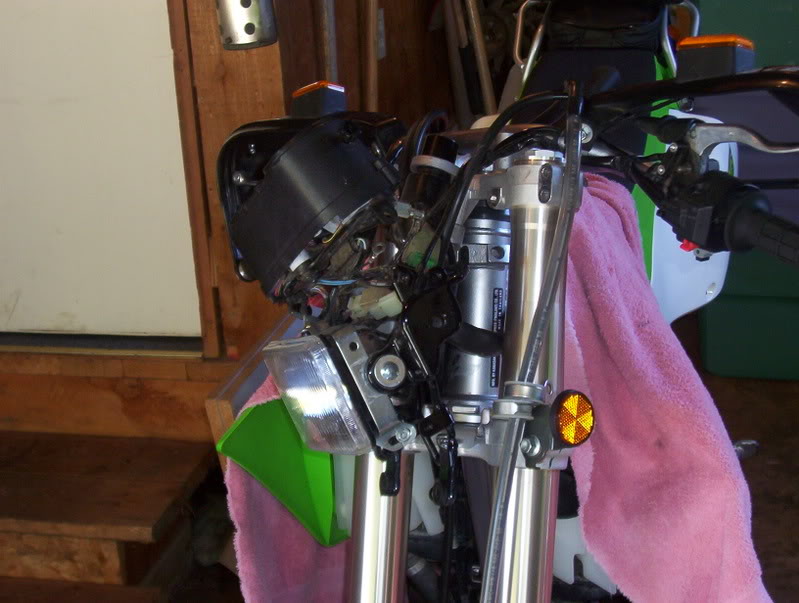

Man the instructions about the klx 300 dirt bike made it look easy, but with our bikes we have a lot more stuff to get out of the way.

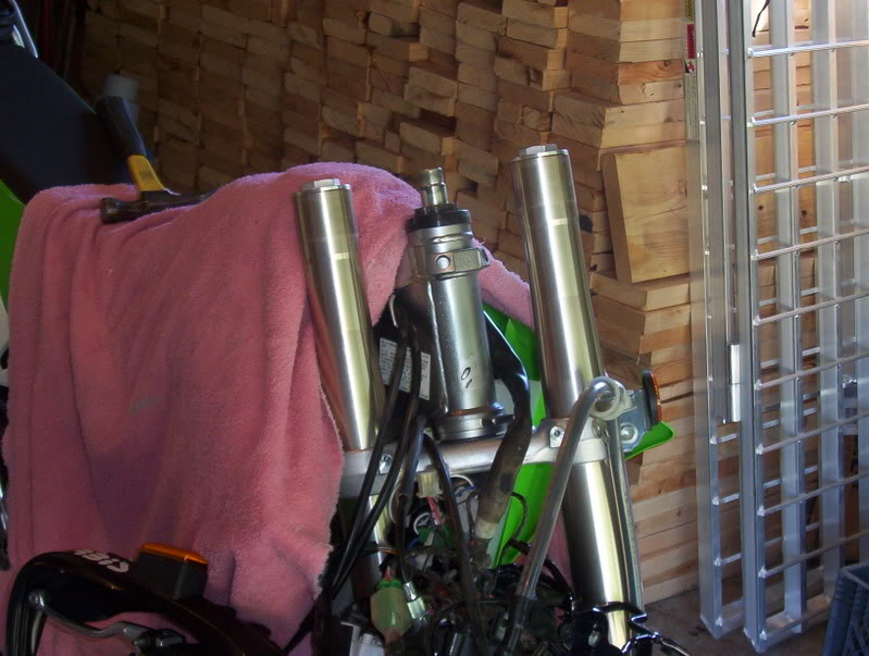

Top clampectomy
I think it was at this point that I started to wonder if I was going to get this thing back together

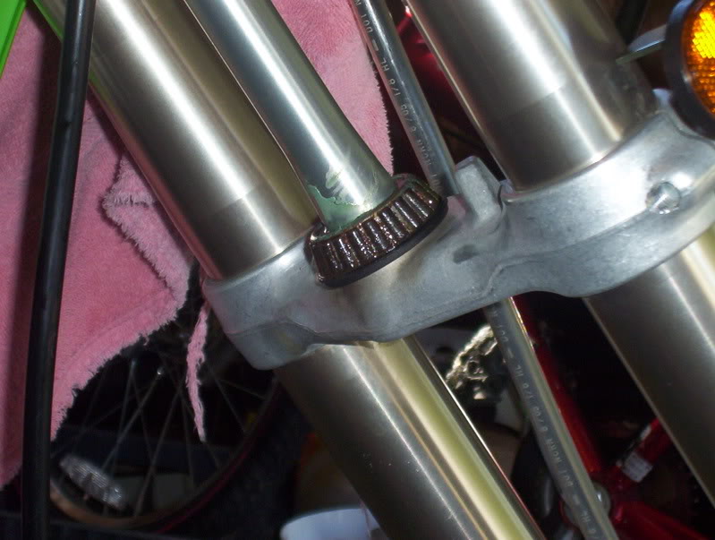

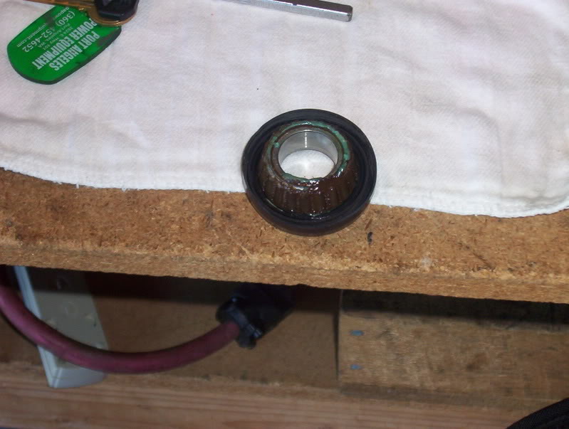

Top bearing, looking a little brown. They really don't put much grease in these things.

Well that's it. From start to finish it was less than 2 hours, went for a test ride, and its perfect.

Awesome photos, deej - I'm really glad you did this as I've been wanting to do mine and now I know exactly what to expect. Thanks man!
BTW, was the brown on those bearings coming from rust? If so, I'm going to dig into mine ASAP.
BBTW, from what I hear, we can expect the same lack of grease on the swingarm bearings, so that maybe should be the next project. I think Marty already did his and mentioned they were pretty dry.

Well I think its just from water mixing with the grease, but the rollers are brown, but in good shape, so I think I caught it in time. Also the shaft had drops of water on it, and like I said before, it hasn't rained for 3 months. And I don't really go through water that much, but maybe all those washes did me in. If you are a river crosser or deep water rider then you probably need to check things out. Just because its not hanging up doesn't mean its ok.
Old Sep 30, 2006 | 05:42 AM
Default RE: Its Baaaaaaaaaaaaaaak!
Double post error GRRRRRRRR
Old Sep 30, 2006 | 05:51 AM
ORIGINAL: deej
An I don't really go through water that much, but maybe all those washes did me in ...
Do you use a pressure washer? That might do it, but I doubt a normal hosing would have enough pressure to get in there. At any rate, the grease not only lubricates the bearings, but also seals out the water. Sounds like there's not enough in there for the latter purpose.
