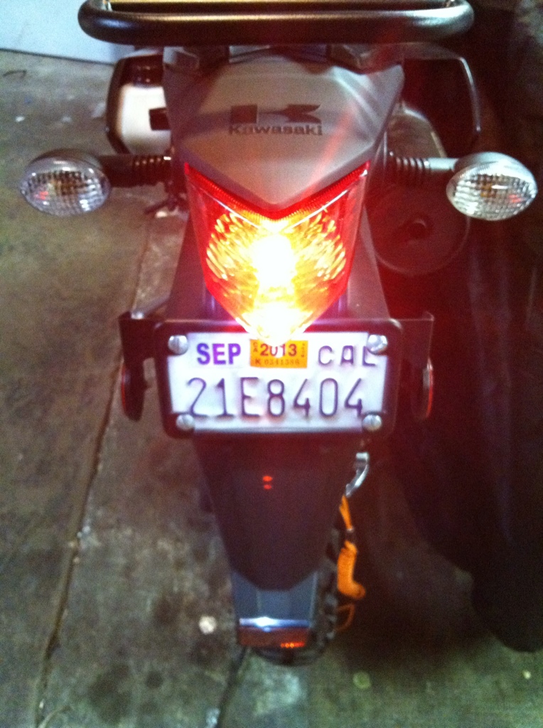

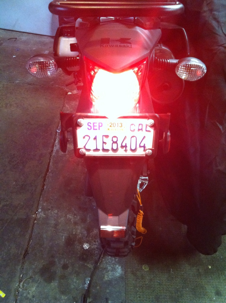

stock brake light brake activated
led brake activated

took a bunch of pics in daylight
stock and led bulb
looks very similar especially directly looking at it
I would say its pretty much the same
at a more of a side angle you can see the led spots more but the bulb is longer then stock
but dead on its good
stock and led bulb
