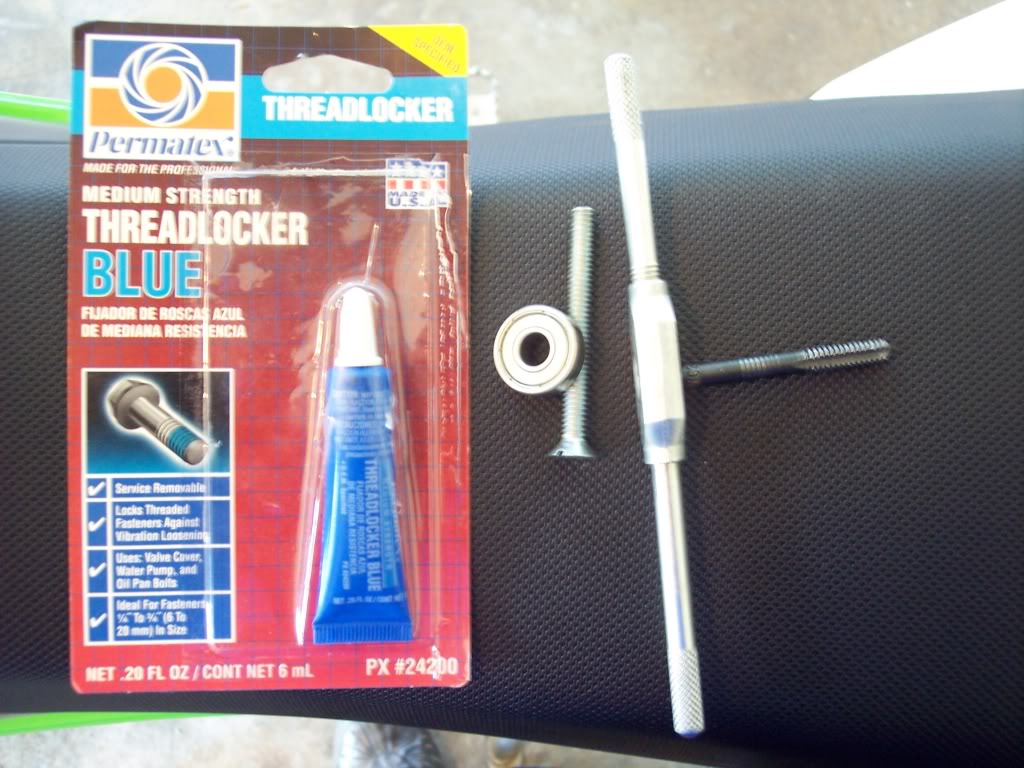

Tools needed:
¼” Hand tap
Bolt x2
Spacers of some sort (not required, but recommended to move the guards out from the grip… keeps you from rubbing your hand and lets you keep more of the levers, bar, and grips.)
Threadlocker
Various sockets and screwdrivers

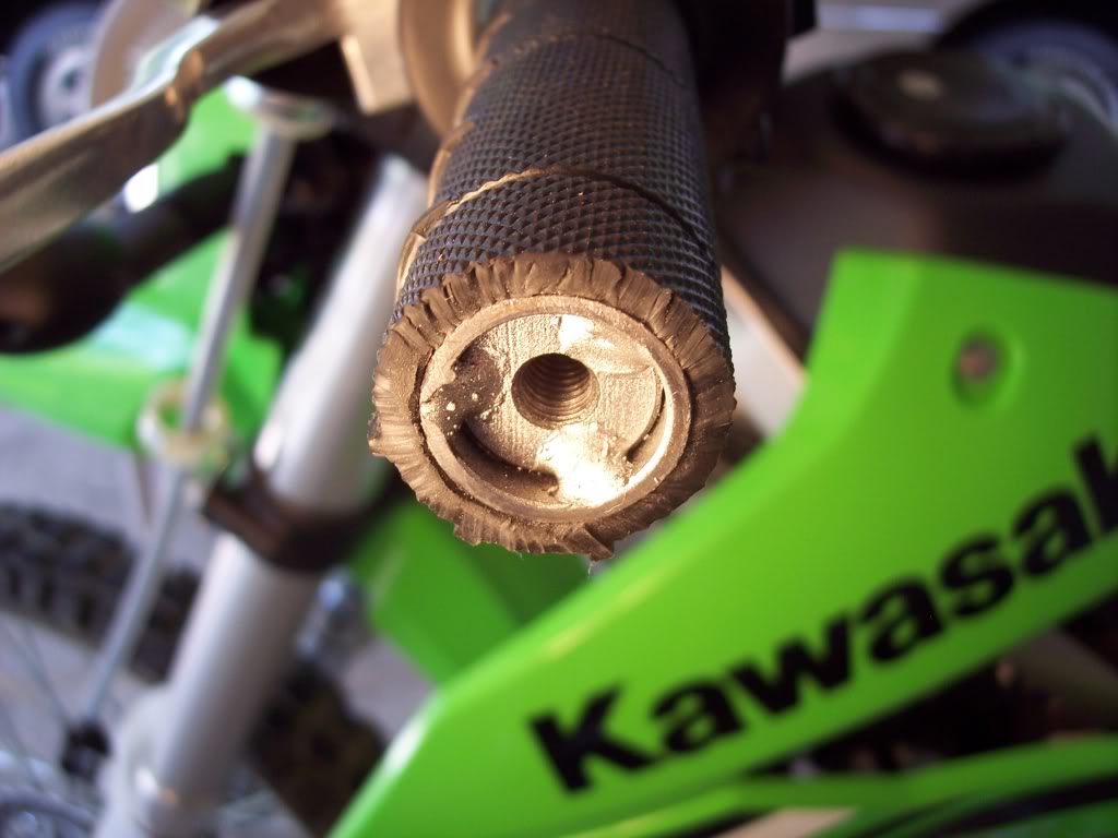

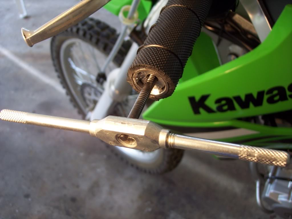

First you need to trim the throttle tube and the grip on the clutch side. Tap the hole in the barweights… the farther in, the better. To properly tap the thread you should only turn the tap one or two turns before removing and cleaning… this gives you cleaner threads and a better hole.

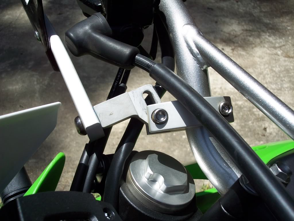

Here is a couple pics of the inner bracket. Not sure why my kit came with a straight bracket where as a lot of other people have mentioned the pivoting bracket.

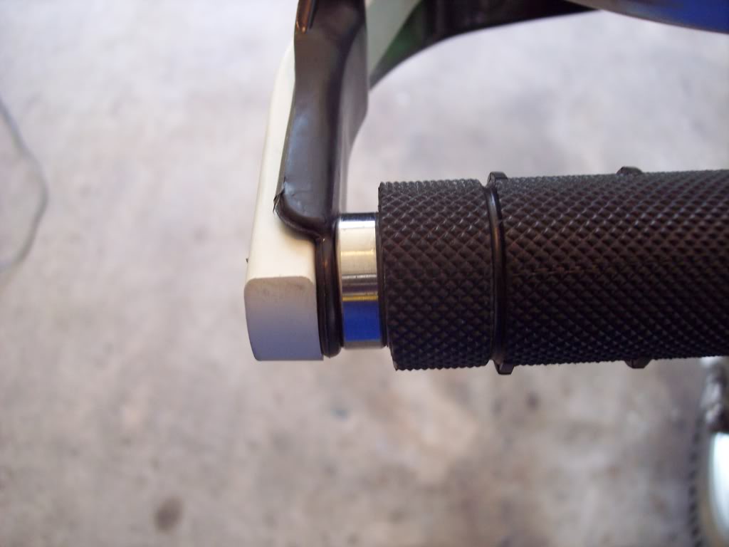

This isn’t necessarily required but a nice touch. Pops added a bearing as a spacer between the grip and the guard to create some hand space as well as clean up the appearance.

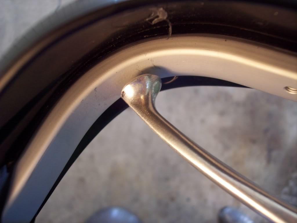

The ball on the levers needs to be grinded down or off, depending on your personal taste. I like having a little bit for that one in a hundred time your hand might slip.

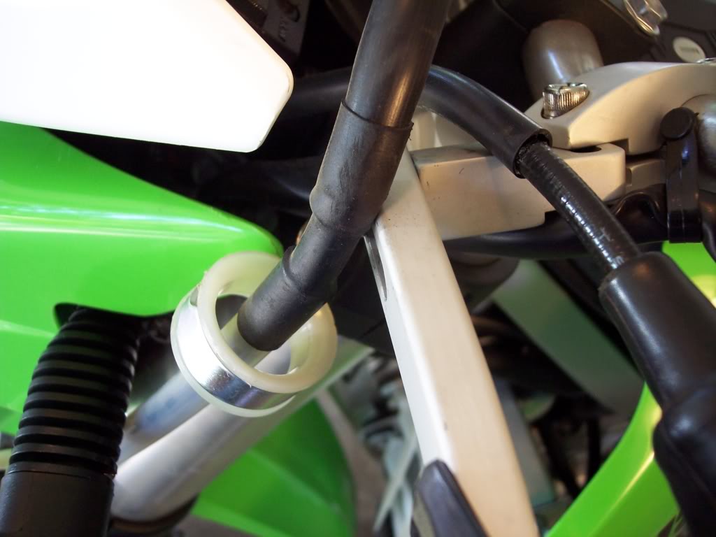

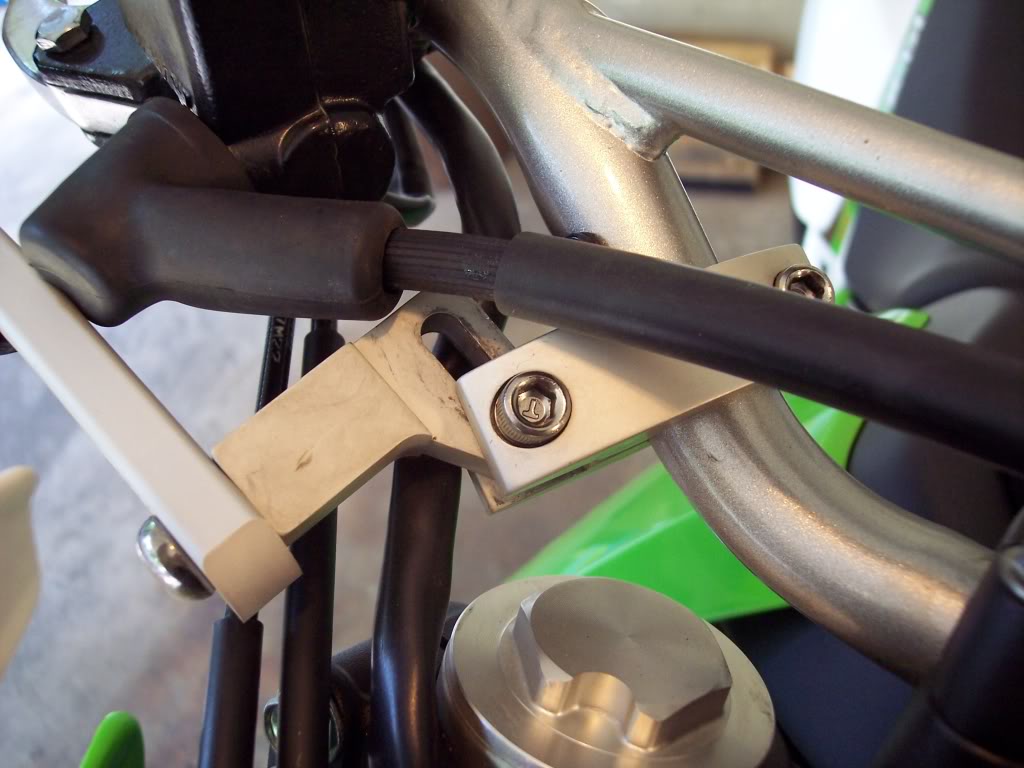

The brake cable bracket on the forktube needs to be taken off and bent to allow the cable to pass the bar without interference. This is how our cable is ran. We wrapped it in electrical tape since it does rub the handguard.

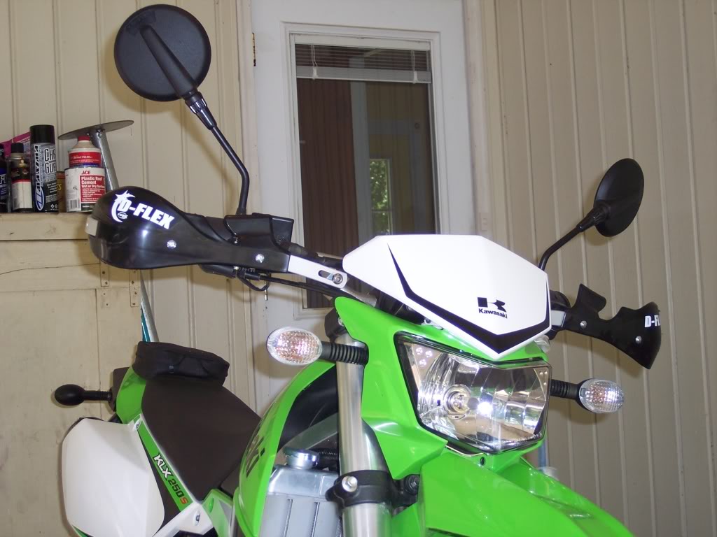

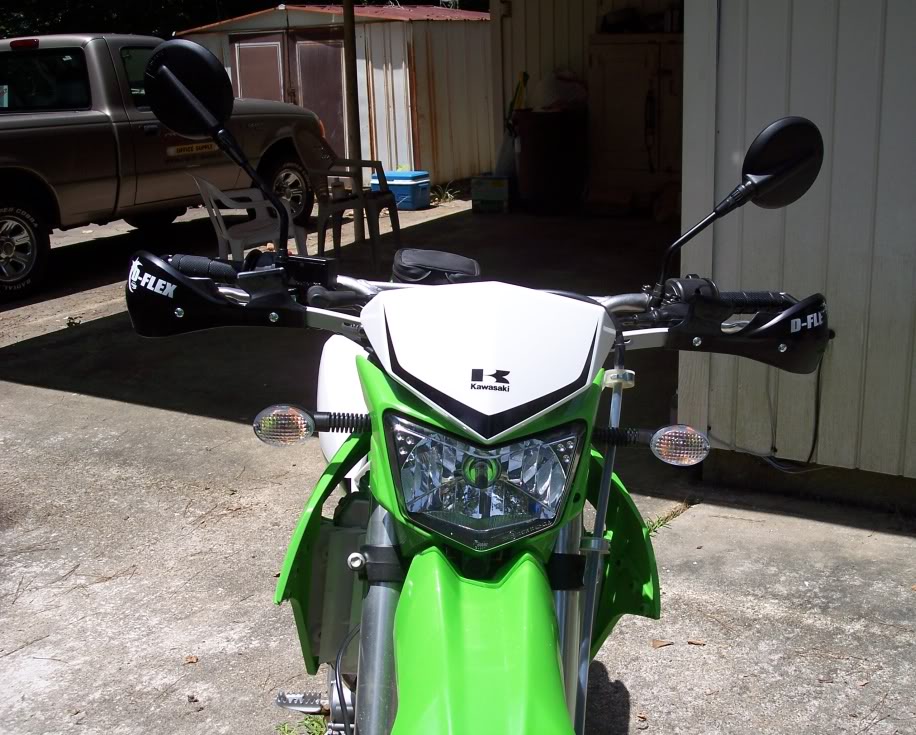

This is the finished product.

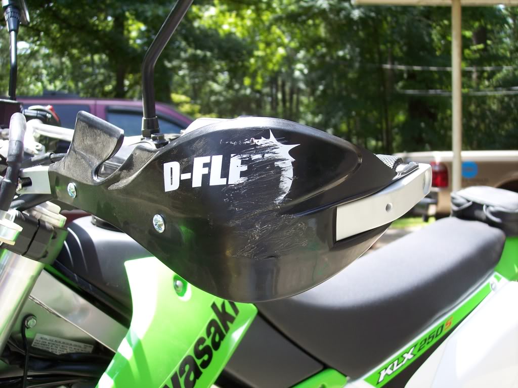

Yes, they do work. Sand on concrete + idiot me = broken in handguards. Glad we got them on, saved me a lever the first day they were on the bike, not to mention oh, my fingers.
