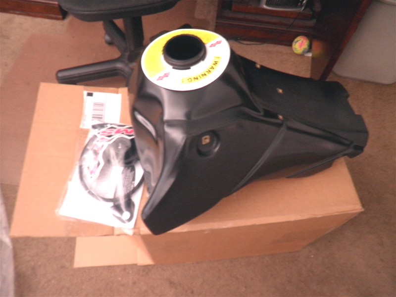

Came home and there it was. In a box the postman delivered.
So I tore it open to check it out.
gonna be busy here for a few.... let ya know how it goes

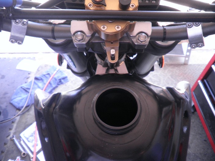

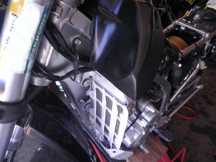

Well I finished installing the IMS tank. I started this thread about an hour ago. So the total install can be done in less than one hour. I made a call to IMS about the wiring loom position (stays in the stock position) and the rear mount rubber grommet (yes take it off the stock tank to use on the tab provided) for the tab that needs to be bolted on the IMS tank. I didn't perform the drilling of the tank shrouds like in the instructions picture fig #2. Its for an extra mounting screw (provided) on each side for the shrouds. I many use it in the future but not at this time as I don't think it needs it. I didn't have to deal with the vent hoses (smog stuff) as they were not there for some reason heh heh.

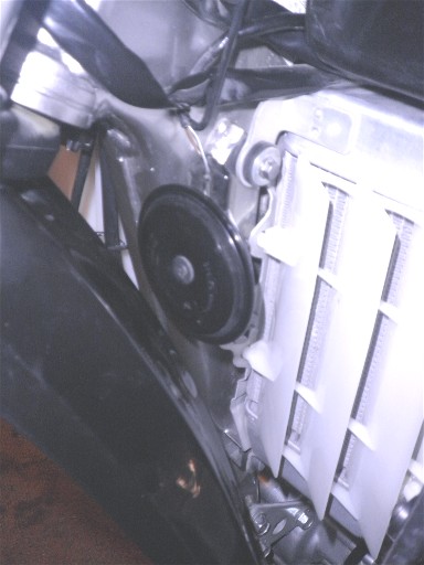

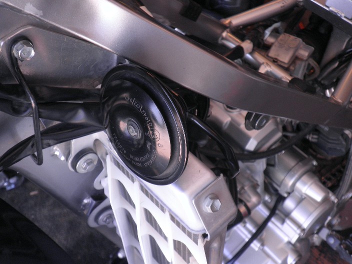

The worst part is that new location I used to mount the horn, the IMS tank uses that space. Oh well....
Looks just like a stock tank! I can't tell the difference.

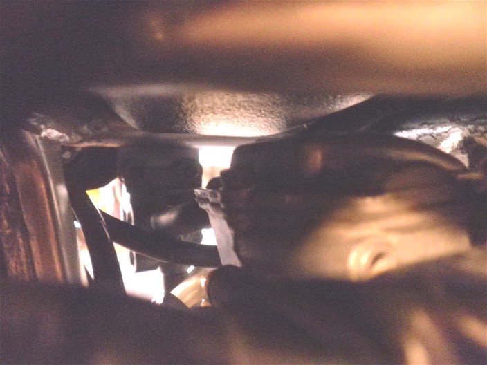

Thanks for the post mate. Can I ask a favour? Can you try take a pic of the gap between the top of the carb and the bottom of the tank? I am concerned that the IMS tank will take more space than the stock one - which I had to shim up with a couple of washers in order to have some clearance between the top of the FCR35 carb and the tank.

What's wrong with the horm mount?

I have the fcr35 also. There is at least .25" between the tank and the top of the fcr35.
'What's wrong with the horm mount? '
In the stock location its hanging there out in the open. So I remounted it above the left radiator getting it out of harms way. But the IMS uses that space so I remounted it again...
