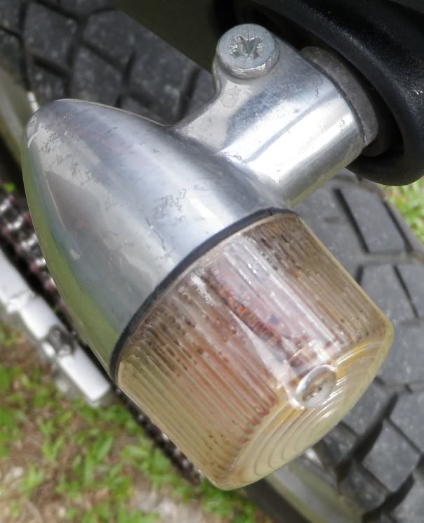

Assuming I can figure out how to get a photo onto the site I would like somebody with tribal knowlage to help identifythe MFR and model of turn signal in the photo. It is my left side which had water drops in it from day one. Even after cleaning it refilled. Now the right side has water also. I want to get a new set, figure out how to seal them up and then install. Name:  sTurnSignal.jpg

Don't know what it is, but you can get cheap replacement sets for $15.

Sorry for double-post, but I believe it is a bikemaster set....link above to Motovan on-line catalogue page. I like those...but I couyldn't get them from Motovan when I tried. Good luck.

Jim, I can't ID them for you,but I have an idea where to look for water infiltration. Look at the point where the wires enter the signal. That could be a point of entry. I sealed that point with silicone on the aftermarket signals I just put on.

could just drill a tiny weep hole at a low spot?

Could not find identical one on the motovan catalouge but thanks.
Have contacted the Ebay guys about the ones Dready linked to. If they will ship to Guam I will get a set.
Dan
I had decided this go around I would seal them up including the wire pass thru with hi temp RTV(Its what I have for work purposes) and also around the lens to body joint. This set looked like it had elchepo oring on the lens to body seal.
Rim Bender.
I think a weep hole in guam might let more water in than out. We got over 8' of rain last year. I want to seal the crap out of the next set. Pitty I cant find the same ones as I like the looks of them.
