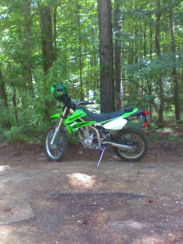

I took this pic yesterday in the exact same spot I took the same pic a year ago:
One year ago:
And yesterday:
