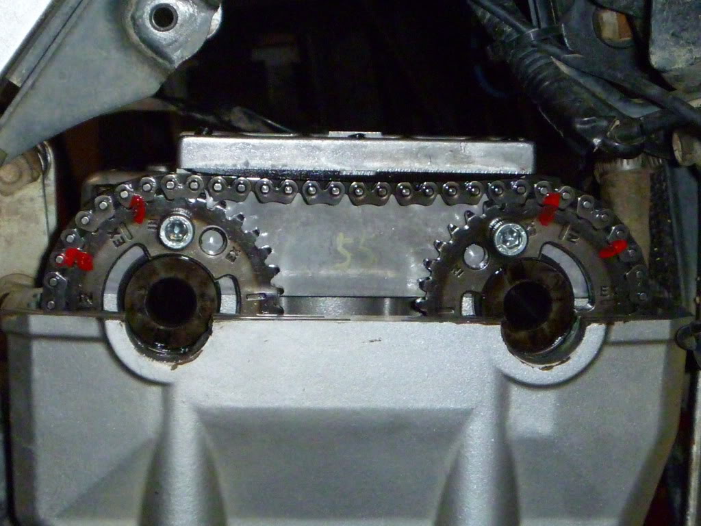

the front cam chain guide was a real pain for me.... took me 20 mins to get it back where it belongs.
I painted the cams and chain so i know where it went.
