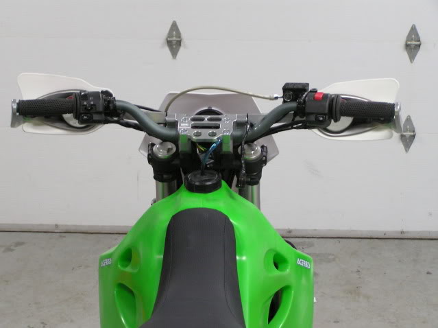

You will definitely need longer cables. I have them on my bike. I have the protaper woods bend on mine, which are fat bars, if you are putting the HDB guards on you have no need for the pivot levers, as the bars will protect the levers against anything that you can live through, save your money for a vapor speedo or the led turn signals that go with the hdb's. Definitely buy the mirrors as they work way better than the stockers. I had a two inch longer clutch cable and it was not long enough. It worked but was tight and only lasted one season. I ordered a three inch longer cable and it is perfect. I also ordered 2 inch longer throttle cables but the stock ones were just long enough so I saved the longer ones for later. The triple clamp size is 90 by 38/40 mm I think because of the fat bar adapter. I don't know why you would want a steering stablizer for this bike but to each his own.
