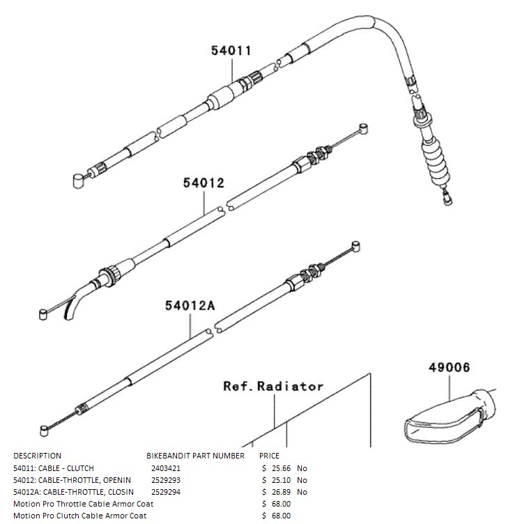

You are definitely going to want new cables. You can get custom cables to length from Motion Pro. You will have to determine what lengths you need.
The image below is from Bike Bandits stock cables.
