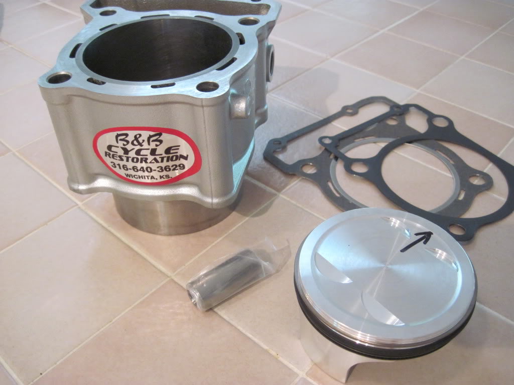

Question for those of you with the 351 kit:
Does the new piston have valve reliefs in it and are the intake and exhaust reliefs the same? Just thinking that maybe the piston went in backwards and there was less clearance between the valves and the piston. Some high rpm valve float and BANG!

For this reason Bill draws an arrow on the piston with a sharpie as to the way it is to be oriented facing forward. It should only go in this way....

I don't think the top of the valve would be sticking up like that, if it wasn't broken - unless the keeper let go, in which case you should be able to pull the spring out. I'm thinking the valve is broken, and the part you see can't be pulled out because the broken end is a bit bent or mangled & won't let it come through. Why it broke is another thing, sure sounds like piston/valve contact, and maybe Brewster has nailed it. Kind of why I was wondering how much room the valves would have after the cam mod changed the timing - maybe adequate for stock setup, but not enough for big bore with some valve float, and really not enough if the piston is in backwards from what the reliefs look like.

Looks like the 351 piston has more relief for the intake side. If the piston was indeed installed backwards wouldn't it be an intake valve that would suffer the failure ?

Did you check your cam timing before you tore it down? Any chance it jumped somehow? Everything look OK in the cam sprocket/chain/tensioner department? Otherwise, it appears maybe a bit of float combined with too close tolerance - it would seem to be too big of a coincidence to have a valve suddenly break like that out of nowhere unless previously weakened. Also looks like the piston was in right, and also like was said above, if it was wrong I think the bigger relief would go to the exhaust side anway.
