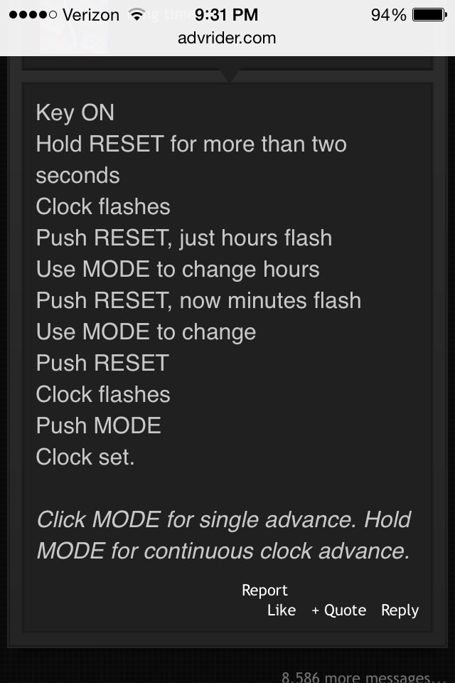

Old Jun 8, 2016 | 03:40 PM
Werloc's Avatar
Joined: Jun 2015
Posts: 539
From: Central, NJ
This is what I found and followed.
Old Jun 9, 2016 | 06:42 AM
Bigs's Avatar
Joined: Jun 2016
Posts: 86
Yeah, that's what it says in the manual - but it doesn't work if the odometer is showing Trip A or Trip B.
You have to cycle through until it is just the plain odometer.
Cheers
