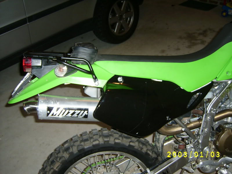

I just thought since everyone else was showing theirs that I would show mine too....

Gravy Train, Could you please tell me where you purchased the aftermarket tail light with the license plate light combined. Thanks
