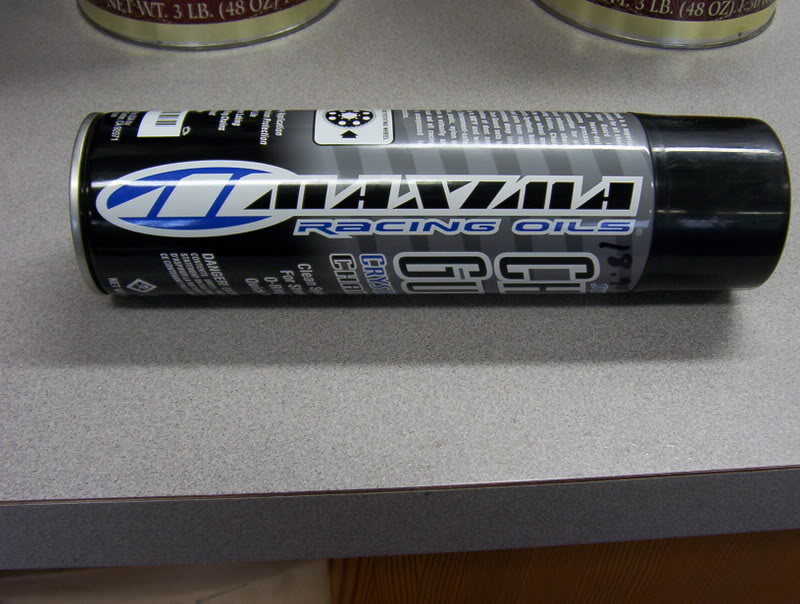

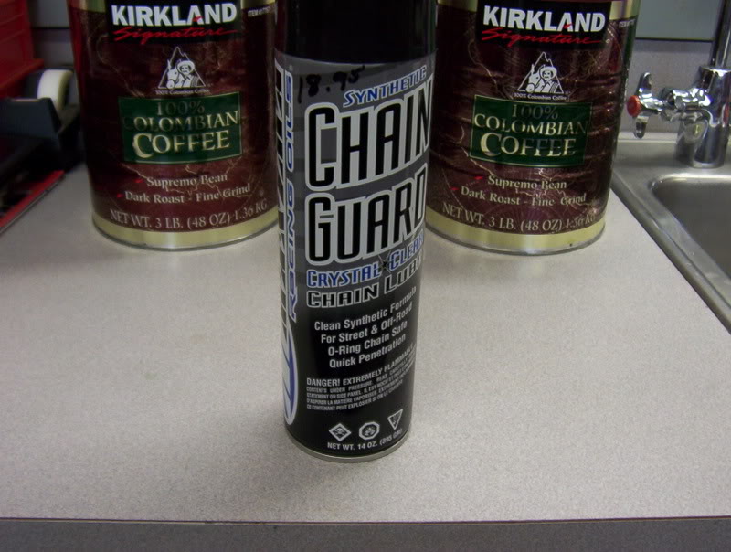

I got this for the chain, it foams up and doesn't fling off.
