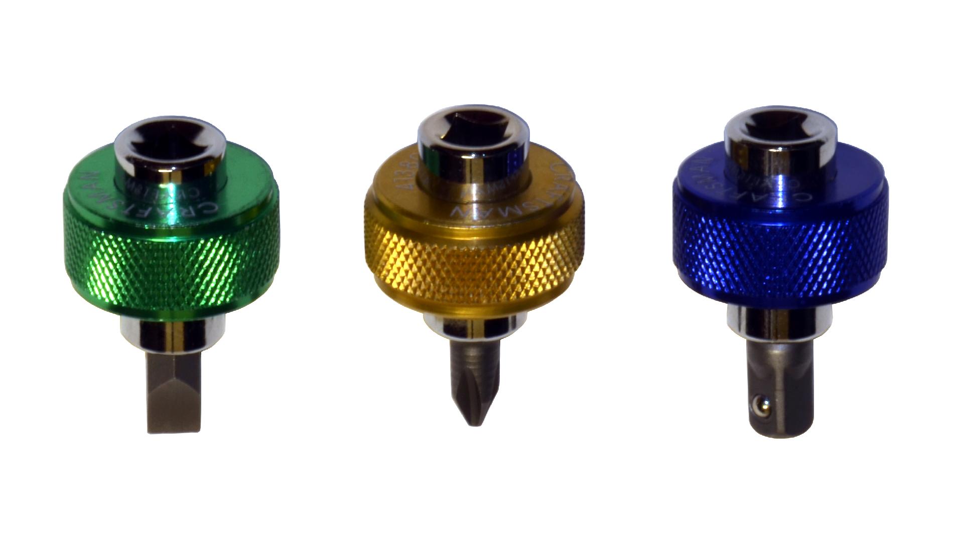

My tool

Originally Posted by Klxster
My tool
ah perfect, so just go buy a cheap little stubby and cut the handle off pretty much.
Do you find that you burn yourself with that? it seems like a really tight space. I guess you only have to do it once and a while though.

I'm pretty sure that is just a bit that you would use in a drill with a short section of rubber fuel hose slipped over the end. Should work just fine and yes, it is a tight fit.

GBAUTO is correct.. And you are correct about getting burned if you aren't very careful.. As you know, you only do it once, so when I did mine, I took a little burn or two.

Craftsman.com
$9 at Sears:

Thanks a lot for all the tips guys, I actually have one of those little knobby ratchets, il try using that.
