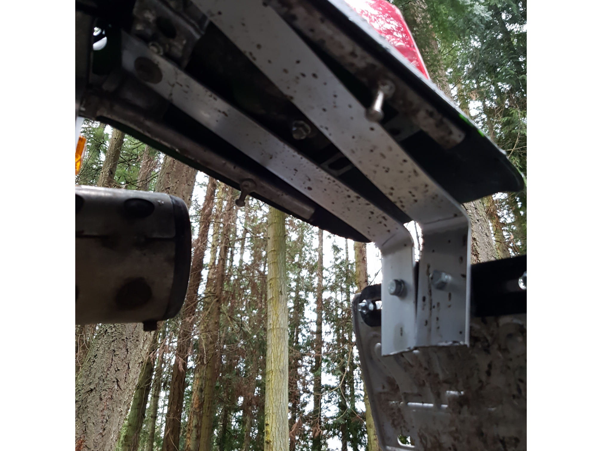

The OEM turn signal mounting tab on the rear rack was the first casualty of this new to me klx. I bought a 8ft length of aluminum and started bending and drilling. Using holes and bolts from the stock fender/ *****, it came together nicely! Amazing what can be done with some imagination and beer

As for the lanyard suggestion klx678, it's a good one but I can't see how my bracket would fail. The plate is bolted to the stock steel plate, and that plate is mounted to 2 separate pieces of aluminum. Are you suggesting that the vibrations would lead to the bracket snapping?

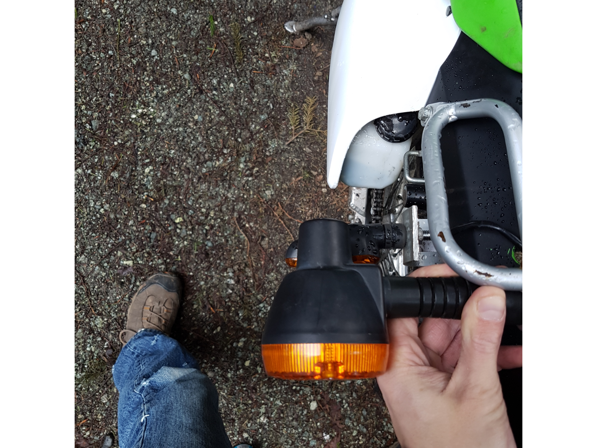

I would say that u will probably have a chance to redue your installation after the first drop on it's side. Those blinkers look like they are sticking way out, I put mine back in close to the fender, who really cares if they are way out?

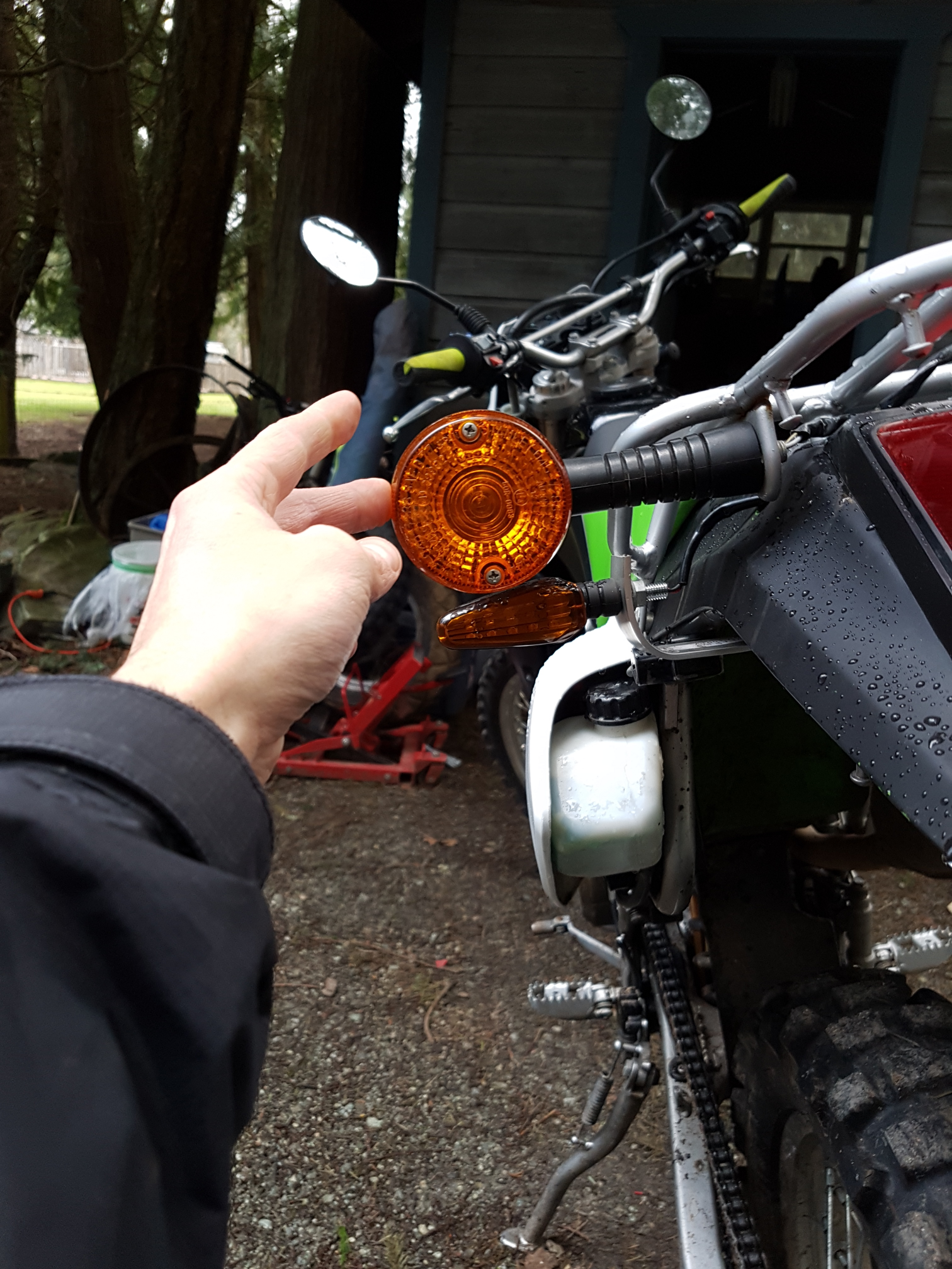

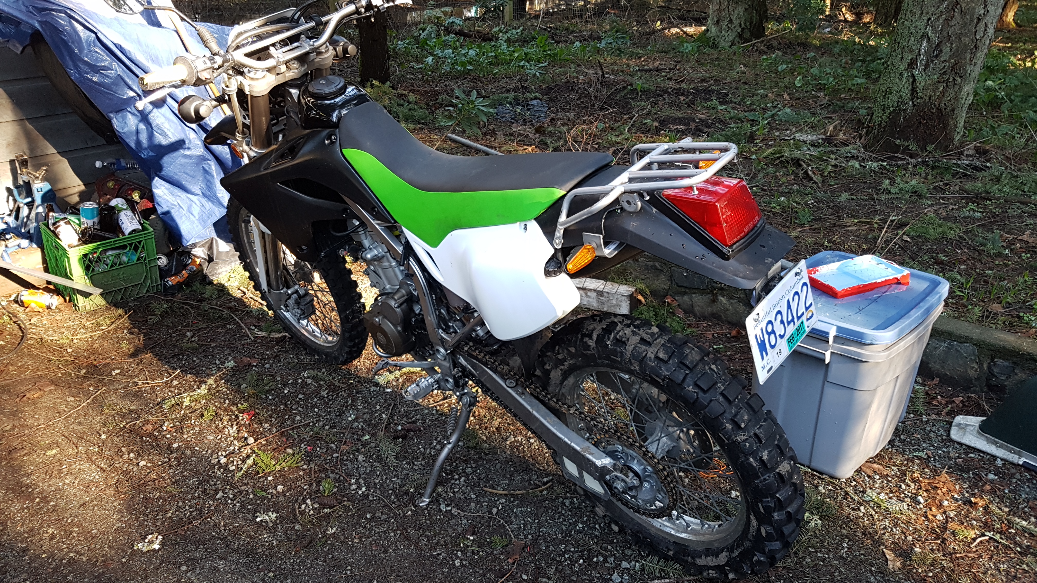

I appreciate the feedback, so I thought it was best to upload a few more pictures to show what's going on.
The OEM turn signals stick out further than the ones I have installed. My turn signal brackets are a quick way to get me legal and on the road again. I would have preferred to mount the DRC LED signals to the stock mounting tabs on the rack, but that requires a visit to my friend the welder.
Who cares how far out they stick? Cops and the local insurance company. If I get hit and they can prove my signals were not visible, I'm not covered. They are sneaky F***ers and I won't give them an inch.
Ultimately, my friend the welder/fitter/fabricator will be asked to make a whole new rear rack. At that point, I'll have mounting tabs installed to the rack and out of harm's way.
Seeing as how I wanted to make a fender eliminator, and the signals had no mount, I got two birds stoned at the same time with my 20 dollar piece of aluminum.
I like to see people making their own stuff, but the turn signals you linked are way to far removed from the OEM orange blinkers. That would indeed get a question from the local constabulary.
I used two pieces of aluminum for the license plate holder, and the bends are not supporting the weight as much as they are allowing for the angle of the plate. If this thing is gunna crack/ let go.. it won't be both at the same time. I have lots more aluminum...
I designed this all out of simplicity, gotta love when it ends being functional too!
