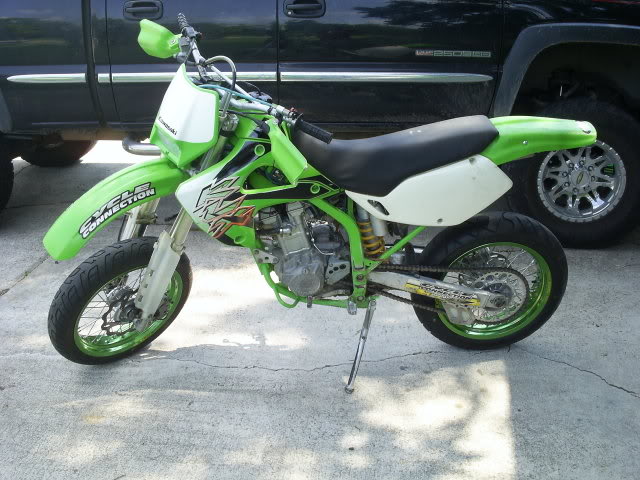

I should update my sig, I have had a set of green excels for quite a while now. I got them while I had my bike apart, so I threw them on my Dad's KLX and had some fun.
My old man's bike with my SM wheels on it.
And here is my KLX that I just recently finished, but I haven't put my SM setup on it yet.
