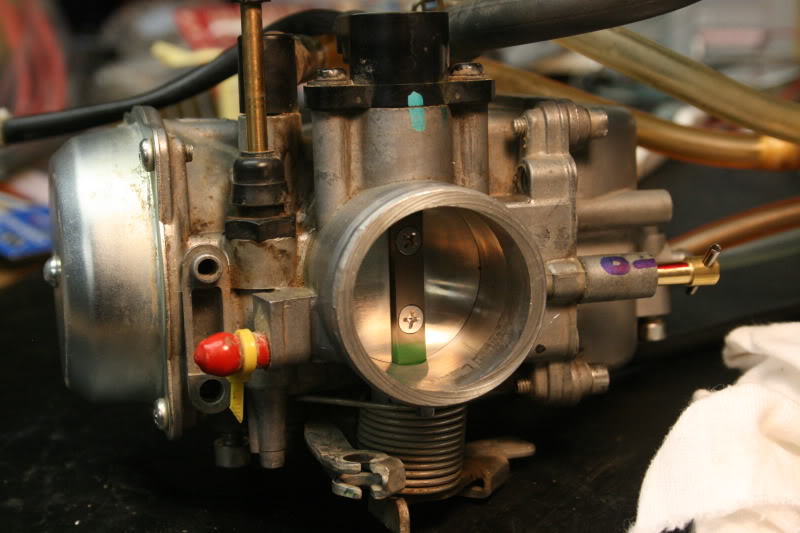

I marked my Kouba screw so I could easily return it to a known good point. That's once you get it to a "known good point" and I should have used a scribe to scratch it in there.

I thought about doing something like that, but you still wouldnt remember how many turns out it is, well i wouldnt at least. Ill just have to fool with it, i changed my klr's from 2.5 turns out to 2, and it seem to make it more crisp.
