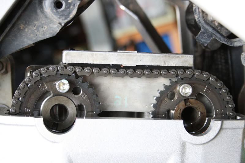

Old Oct 8, 2014 | 02:48 AM
Richard Avatar's Avatar
Joined: Mar 2013
Posts: 866
From: SE Asia

I have had a new battery and tried with other batteries. It's been running and starting fine for a couple of years until this slow cranking has gradually started.
I will get a multi meter today and report back with my findings. I was thinking it may be something to do with the ACR too.
