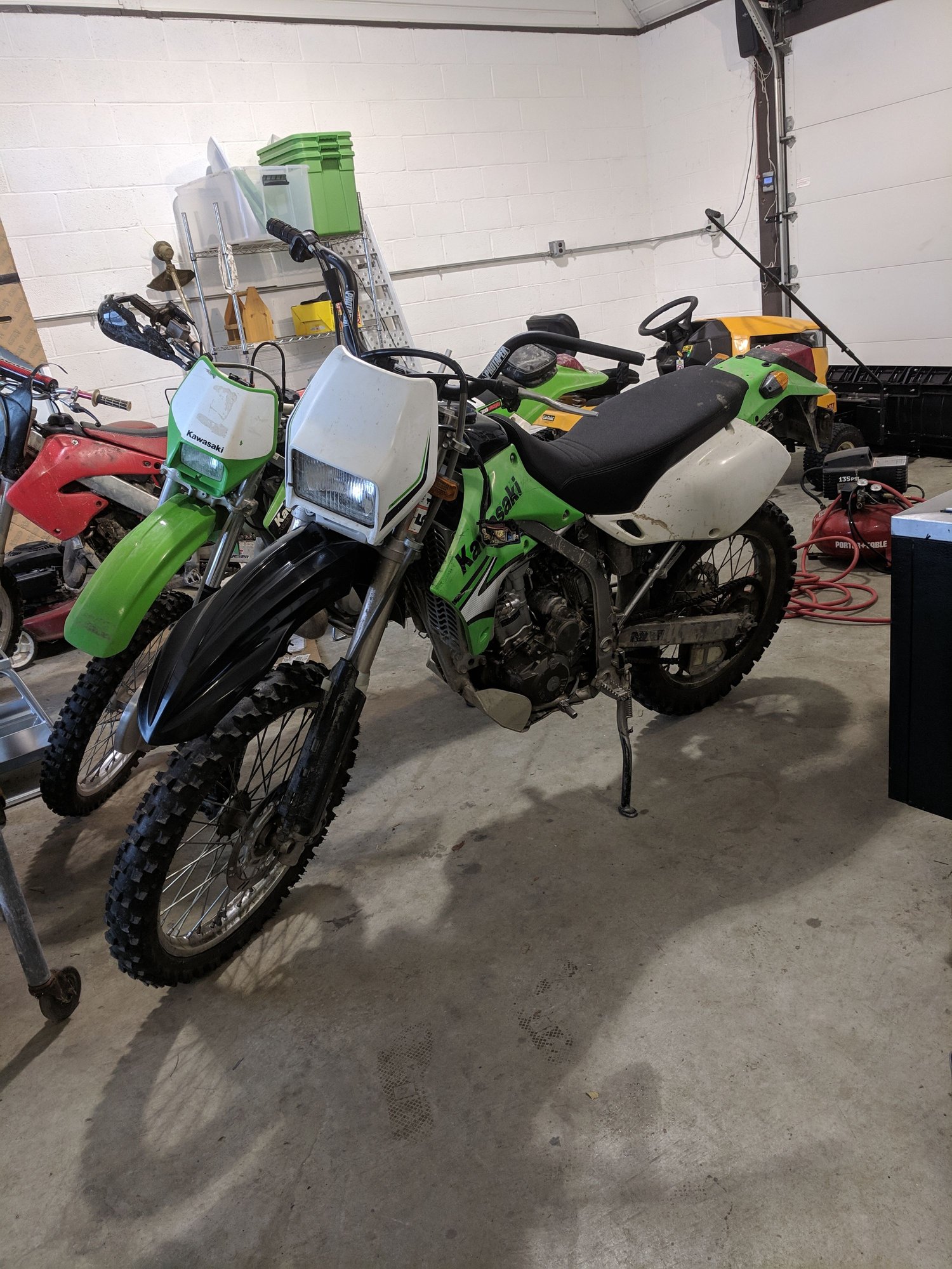

hey all,
another winter build here. I'm going with a 351 kit w/pumper carb (just arrived!) and swapping all plastics out for more modern look. i'm 6'2 and after riding on my KDX220 i can't stand the factory bars so i also got some pro taper adventure high bends. I may end up getting a lower bar, they are WAY higher with the adapters and i'm just sure i'm happy with the look (however it sure is comfy when i stand up on the pegs). I was able to squeeze the throttle on but its too tight (had to cut an inch of the ends of the bars) but the clutch doesn't stand a chance.

Interesting on the waiver. I guess my throttle cable from them is close to 2 years old now, and there was no warning or waiver. Does that mean I can contact an attorney for a big pay out? I hear Michael Avanatti is available now...LOL! OP you'll be fine with the one cable. Man, those bars you mention in your pic really are tall, aren't they.
