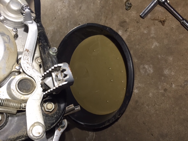

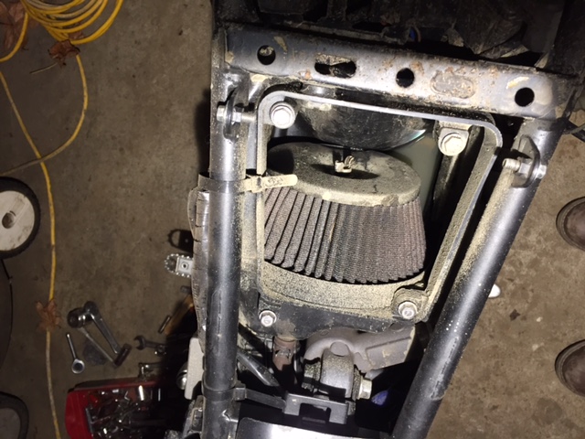

Another question: the airbox has a kind of sump with a drain line guiding down to a sight tube (like an empty fuel filter) that hangs real low. my airbox is missing its lid I'm sure to help it "breath" with the fmf exhaust. recently I was riding in such bad conditions that the drain pipe filled with a gravel/mud slurry and the airbox filled with enough water to drain through the crankcase breather into my oil and get a chocolate milk mess!! I know, I should get a lid and snorkel if I'm riding like that i guess...(not sure how that will change jetting?) i didn't put the site tube or plug back in after i got it all cleaned back up. I was thinking a free drain is better with no lid. seem right to you?

Thank you, I appreciate the help. here a few pics if my airbox debacle......

I'd say get a lid and the KDX200 snorkel, it has twice the cross sectional area of the stock one, actually as large as the tube between the air box and carb mouth. You might also consider getting a new foam filter too. They do work as well or better than the K&N for off roading. If they didn't, all the MX and enduro guys would be running K&N.
You may be able to score a cover here or on ebay, the part number for the snokel is in the Cheap Mods link in my signature.
