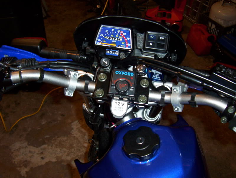

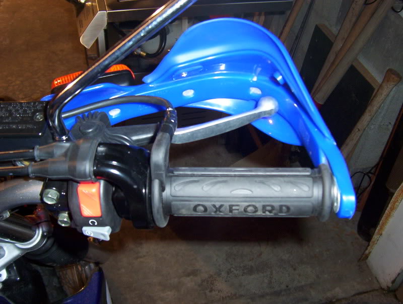

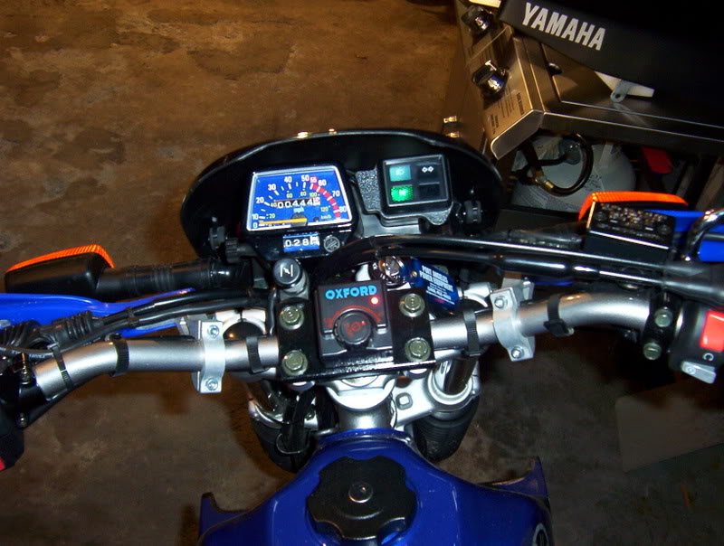

Hey Truckman, I just hooked them up to the keyed power and it was done. I also made a bracket for the ones I installed on my wife's bike and the other 225 in the garage. Here is a picture. What brand did you get? Did it come with a variable setting turn switch? Check this out and let me know if it looks the same. Also I have some of that same material left, its from an access panel to a computer desk. It had the perfect bend in it. Let me know what ya think.

Of course unless you have the after market bars without the cross bar, that bracket might not work.

Heated grips control and 12v accessory plug.

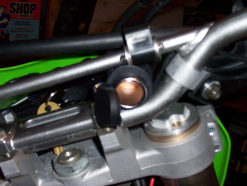

No I don't have them on the KLX, but I did install a 12v plug on the KLX so I could plug in the battery maintainer, charge a cell phone or run a GPS, plus I can use a jumper cable between the bikes and get one to start if the battery has run down. Tested it in the garage, and with the wife's bike battery run down, I plugged in the cable from my bike to hers and ran it for 3 minutes and it started the Yamaha right up.
