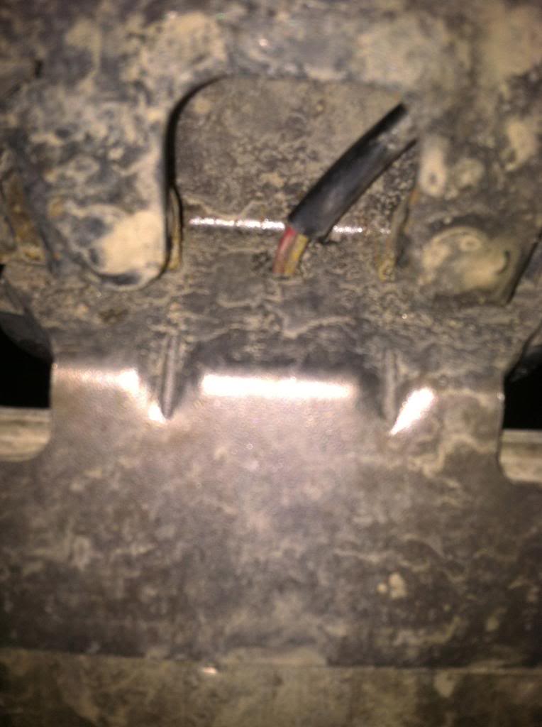

Given the past week of riding through snow and salt and sand, I thought I'd better investigate further, finding this inside the waterproof(not anymore) housing.
So I ought to at least try and clean it, see if it works still. But with what?
I'm thinking alcohol?
If I can't get it to work then I'll put the stock light back on, but I'll have to connect it redneck style(twist lock and electrical tape), until I get to town for worthy electrical connectors. I had to cut the plug off the harness to wire up the Edge originally and the connectors don't match the stock plug.
