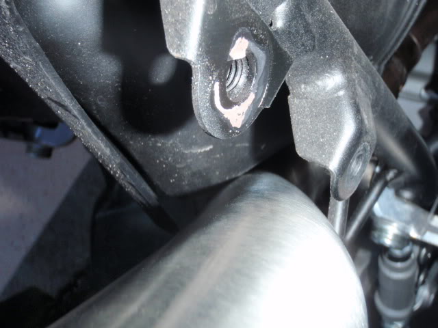

As detailed in another thread my Two Brothers exhaust is almost touching the airbox on my 2009 KLX250SF. See pic below.
I'm thinking about putting some heat sheild tape on the airbox where the pipe is located.
Any thoughts on this? Good or bad? I want to protect the airbox from melting due to the exhaust heat and was thinking this might do the trick.

Old Jan 30, 2011 | 07:42 PM
No matter what you put on there, the plastic will melt unless you move the pipe some. Bend the foot guard out or cut it off. The pre 09 bikes didnt have that guard, and the exhaust mfgs must not have checked the new models very closely. \Pipe is too close to the airbox.
Dan
Ugh. Okay....
But how do you bend the foot guard? I'm a simple man with simple tools in his garage.
Old Jan 30, 2011 | 07:48 PM
I should add that my kids have melted their shoes on my FMF pipe next to the passenger footpeg, on my 07 without the guard.
Dan

So I won't have any passengers but I'd rather not cut off the triangle; I'd rather bend it outwards.
Old Jan 30, 2011 | 07:55 PM
To bend it looks like the best way would be to remove the muffler, put a few layers of duct tape on the frame opposite the guard , put a lever ( big screwdriver , bar, small water pipe, etc something sturdy but not too fat) to the inside of the guard, through the guard to the outside of the frame where you taped it up. You should be able to bend the guard out pretty easily that way.
Dan

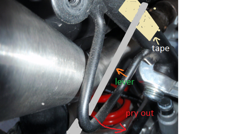

Old Jan 30, 2011 | 08:16 PM
If my description didnt make sense
