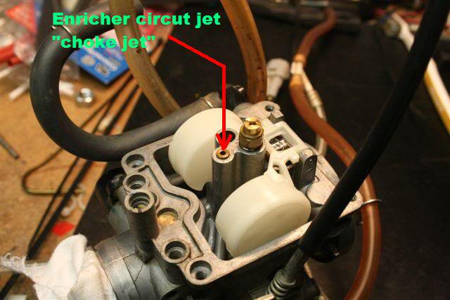

I searched and was going to point you to some threads on drilling the enricher jet ( choke jet) but the search function here on KF , and I , dont always get along . Here's one thread
https://www.kawasakiforums.com/forum...e-34211/page6/

Most of them right out of the box, "06" and up, are hard to start when cold. I Guarantee that the enricher jet is your problem. Definitely prudent to check the valves and rule that out, but from personal experience and discussions on this board, my money is on the carb.
Dig around on here you will find more info.
It helps to start cranking with the choke button all the way in, and slowly pull it out as you crank it over.
I wish you well
DAn

Hard cold starting on the KLX is a well-documented common problem which can be solved in moderate ambient temperatures with an enlarged choke jet. In cooler temperatures, I also utilize an inline primer bulb I fitted. In cold temperatures below say -10C (10F) I have not yet found the cure.

Yep. That's what my manual says. That's why I didn't suspect my valves at first. I removed my carb, cleaned it, drilled the choke jet and still didn't start. That's when I started looking elsewhere, and found the valves to be tight. It does start easily now with the jet drilled and properly adjusted valves.
