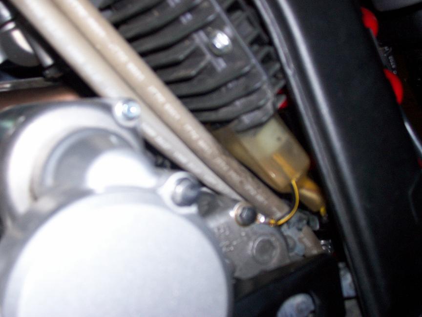

Originally Posted by wildcard
thats the rectifier, the part you are grounding. the budle of wires plugs into that and then you add/replace the ground coming out of the box (the yellow/black wire).
IS this the mod that everyone is doing is there any other benefits to this mod
yes that is the mod. And no there isn't any other benefit other than helping to alleviate the miss at ~6K if your bike has it.

Well, just got done with the ground wire mod everything went really well I used a wire brush to clean everything around the bolt area and the bolt itself and I even used a gold plated connector for maximum conductivity. There was already a hole in the plastic connector cover to stick a wire through like they already knew it was supposed to be there from the factory for this mod lol. One thing I noticed though is that I already had another ground there for something else and that one wasn't there in the previous pic in this post.
