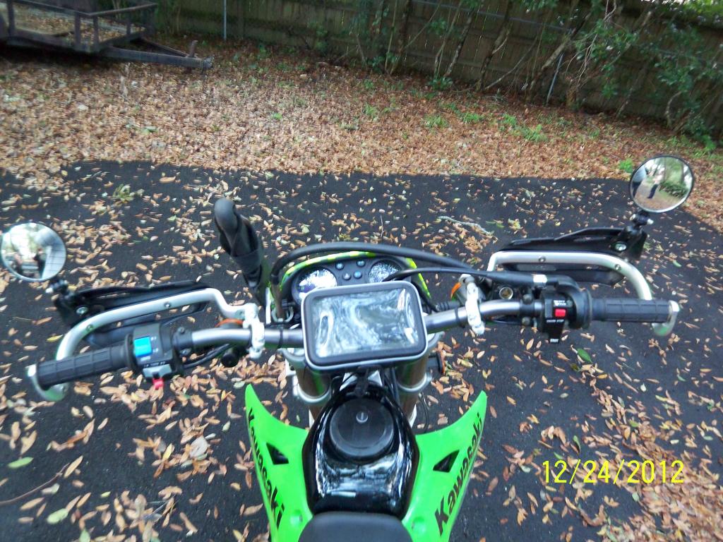

I'm using this type with my oregon 450
100 Waterproof GPS Satnav Motorcycle Bike Case Cover Bag Handlebar Mount Holder | eBay
It comes with a ram style post I cut that off to lower the unit more.
I use this generic hardwire
Hardwire Power Cable for Garmin Nuvi 200 200W 205 205W 250 250W 255 255W 260 265 | eBay
it has a straight mini usb plug that works better than the high dollar garmin that points the cable up toward display. I potted it in rtv as per a post I read somewhere. I've been happy with both.
