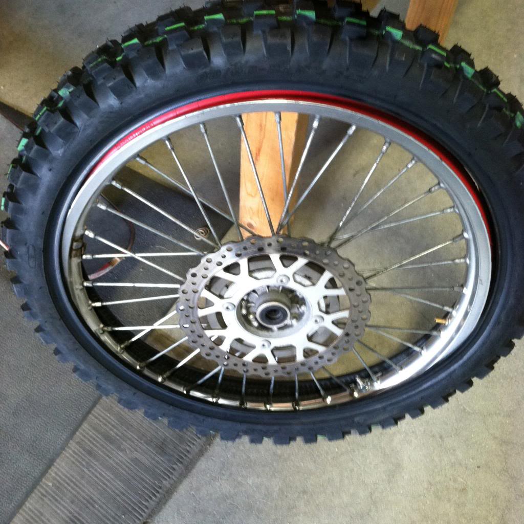

So my Shinko 705's had really left me with the desire to go supermoto...a left over of my Ducati days...really getting on it and hitting turns WOT...
With the new knobbies, I really wanted to save some meat on the tires, by not railing the turns(at least on the road), and I figured 10psi on the road would slow me down. It did, but off road!!!!!!! I could hit anything and just keep on keepin' on.
Holy crap, I love the Tubliss!!!!!!!! I hit a square ledge rock, felt the rim hit and just kept rolling. No flat!!! Love it more than my new Dunlop 606's. And the 606's feel just like whatever tire I rode as a kid...almost no traction until it counted, then all the traction you needed.
The only pic of the install I grabbed...it shows the Tubliss set up on the rim, inside the tire.
