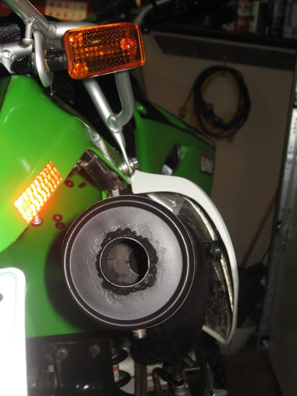

That pea-shooter is a pipe welded inside the muffler...if you can get it out, you will like the sond..I had to trace a circle around the hole, drill a series of smaller holes to cut it out only to find out it was a pipe welded further in the muffler. BUT with some persistant persuasion with the vice grips, I managed to break it free and continue my baffle reaming..here are the results...

just the first one..the pipe is only about 4-inches long (if that) it's attached at the end of the muffler and to the first plate (baffle) inside the muffler.
