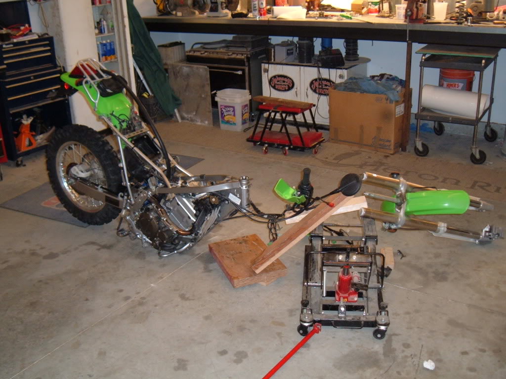

Originally Posted by EMS_0525
Unless you have both tires, swingarm, forks all removed then if you try to take the steering stem bearings apart the bike will want to fall backwards, lol almost lost it. 2 straps after that.
Lesson learned...the hard way
Old Mar 1, 2011 | 03:32 PM
  #33
hhaha..... oops.... i had the rear tire and swingarm off so i guess mine took longer to fall than yours, so i saw it and caught it.... im sure that was fun getting back on the jack.
