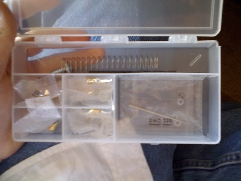

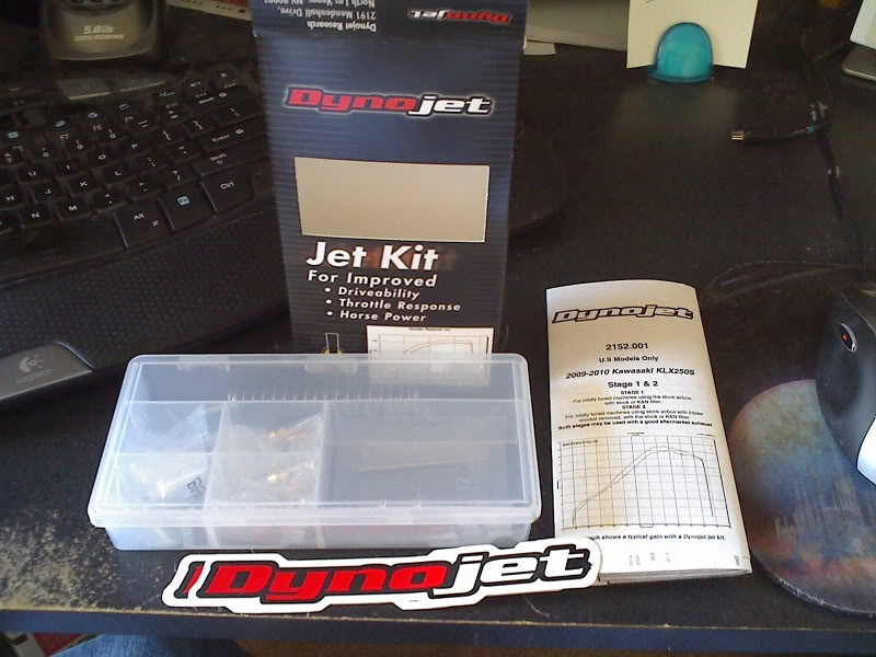

I order the Dynojet direct from the DynoJet website. And the KDX snorkle I ordered from bikebandit.com. The Dynojet is stage 2 actually. Followed all the instrustions except the 3 turns out on the idle/fuel mix. Did only 2 turns out on the idle/fuel. Also used a 124 main jet since I don't use a aftermarket exhuast.
The DynoJet I ordered and whats inside. The kit includes a set of main jets from 112 to 132, new DJ needle, and slide spring.
Something else I just realized. The kit is only suppose to come with 2x needle adjusting washers, but mine came with 3x washers. And I used all 3x washers. I wonder what the effects were.
