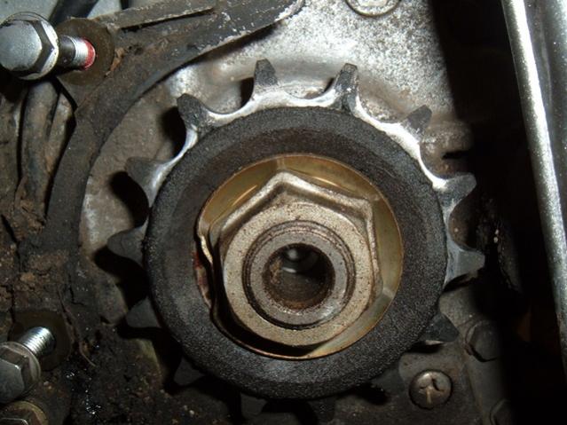

What rubber chingas? We don't need no steeenkin rubber chingas... didn't see anything like that on there. I just remember that freekin nut needing a decent impact to take it off.
Old Jul 31, 2011 | 08:59 PM
IDRIDR's Avatar
Posts: 4,507
From: SW Idaho
Here's a pic of the rubber chingas before plugged with mud and removed.
